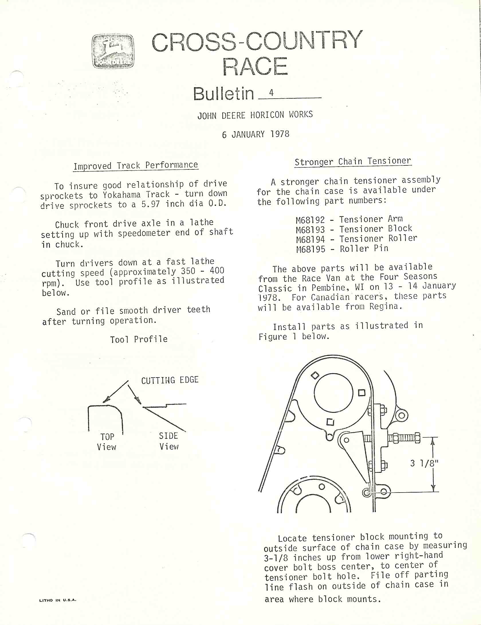

Re: Another 78 CC Found...
Post by TOYMECH »
Greg
Thanks for posting that!
Post by JDRIDER »
Wow! That is good stuff! Thanks for sharing
