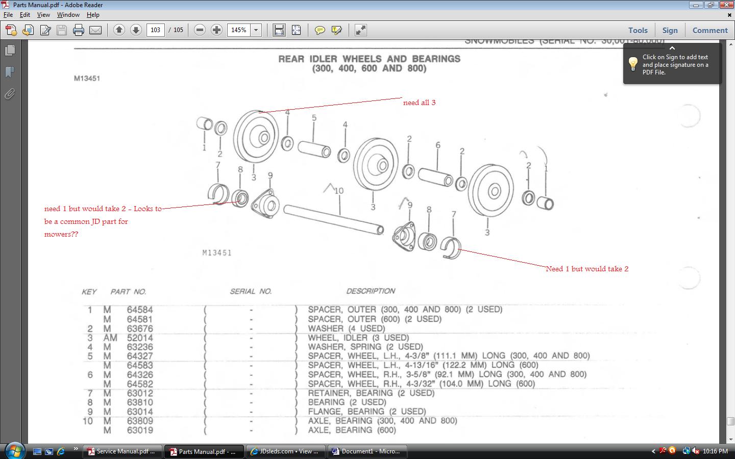

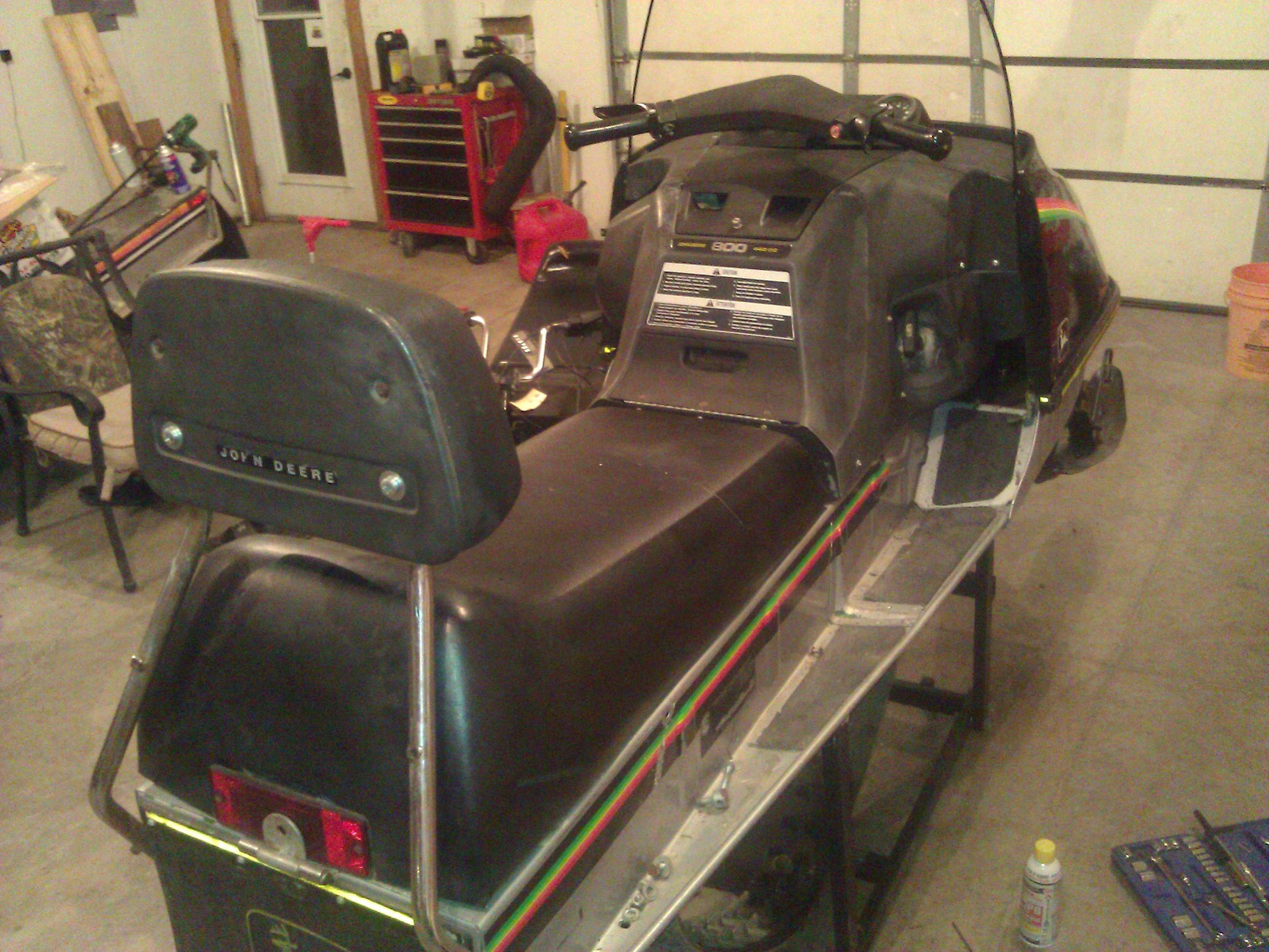

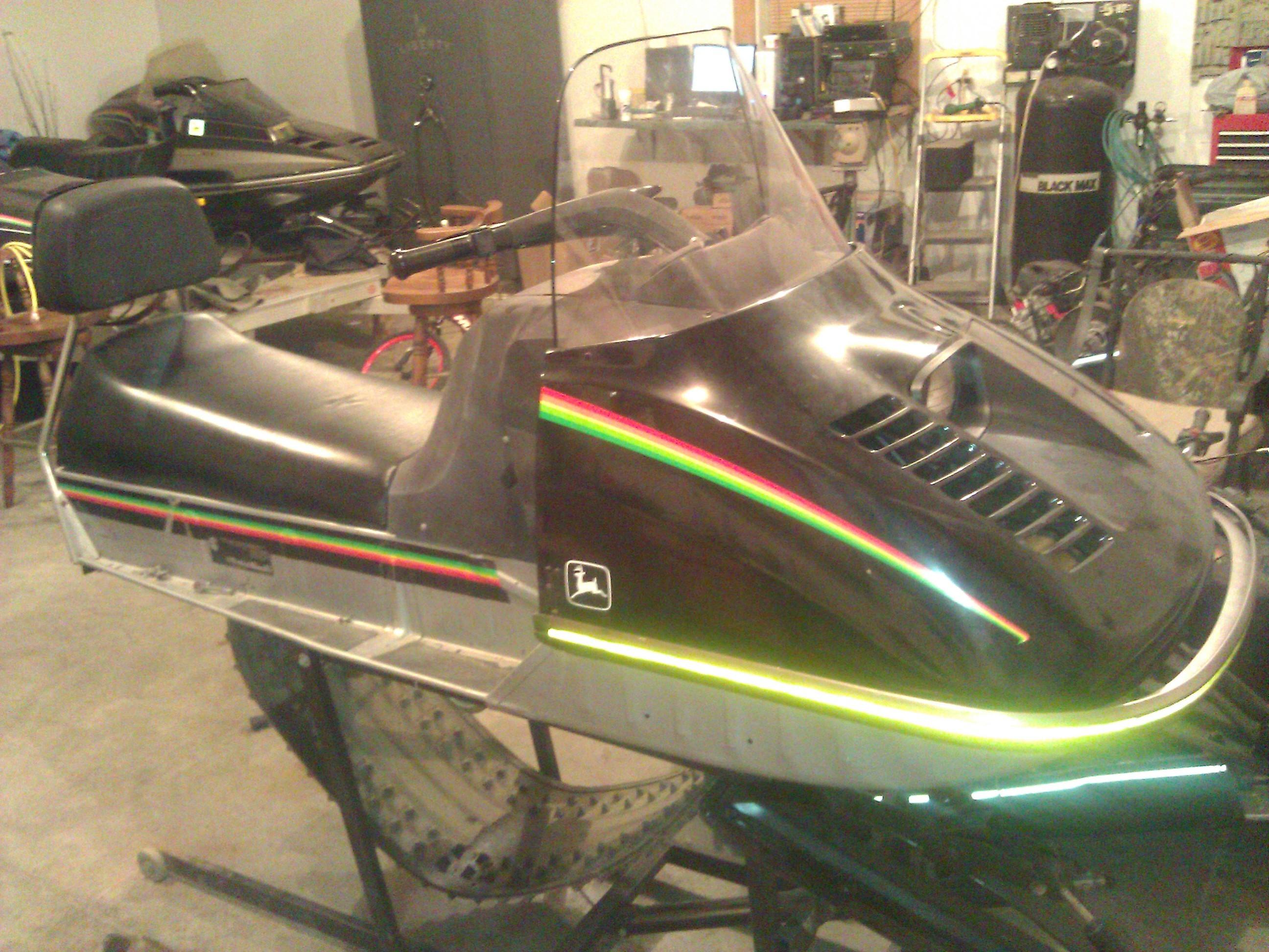

Guys, I acquired in a nice trade a very special ’75 800 because it was cute (so she says) and we don’t get a ton of snow down here and the bogies are attractive for this and it was the same year I was born and I have a problem with purchasing JD sleds that I will never admit……..
I am looking for the following parts and would appreciate any help.
Thanks:

That bearing is a 6205-2RS which you can get anywhere including the Deere dealer. You will probably have to settle for used wheels unless someone happens to have them NOS, those are odd ones. I will look at a set of mine and see if anything new would match up. I think that a Bearing shop might have that rubber piece that wraps the bearing.

That is a very clean straight sled you have found. Congrats!
