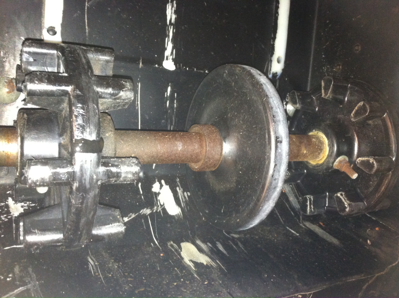

Last night I removed the suspension. Everything looks really good. I hope I have time this friday to media blast everything. But we will see. I still need to take the drive shaft off.
How do the drive cogs look to you guys?

I don't like to tear everything apart until I have all the parts to do the job. That means less losing things for me and I remember better where things are supposed to go. But tonight I went into the sled to replace the track, and found a broken chain tensioner. So I'm going to take some time and just clean every thing whether it needs it or not while I wait until I'm ready to deal with this some more. Its getting to close to summer and I need to make sure my summer toys are ready to go before I spend more time with the sled.

I am finally getting time to mess with the sled again. The service manual I have found online isn't as helpful as I want it to be. Does anyone have pictures of where all the spacers, bearings and flanges go on the driveshaft? When it came out, parts flew everywhere!!!

Todd's advice is rock solid. I Just have a few things to add:
Deere service and parts manual are still available in print, and I know there is a parts manual on line at "www.jdparts.com" or such. The parts book it a good way to check assembly order. Even on a sled I have rebuilt from a bare chassis 2 or 3 times, I keep the manuals handy.
Any of the slide rail sleds from 74-77 that used the bonded cleated track should have a track swap before running them. I have yet to see one of those Goodyear tracks that is not dry rotted. At the very least, rivet the cleats on, but I still would not recommend using one.
The closest rubber track to the original cleated unit is a 16 X 121" Cat track. It originally came in a 3.29" lug pitch, so they have ended up on several Cross Country Liquifire's, but the aftermarket version has a 2.52" pitch. I have not seen one adapted to a mid-mount, but it could be done. I think the guys on here that have done it narrow the suspension rails center to center by about 1/8 or 1/4" or so.
Good luck with your sled. Oh, yea, last thing: the tensioner blocks in the chaincase are still available new from Deere.

Thank you guys very much. I ended up getting the driveshaft back out, put the spacer I forgot back it, and I am starting on the suspension.

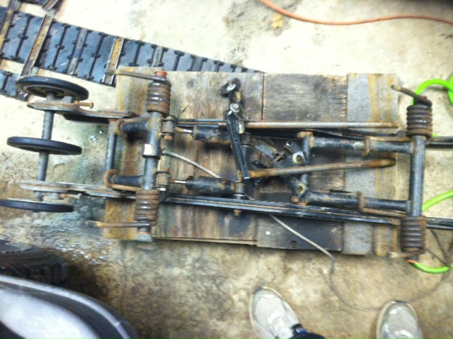

Right now I'm struggling with how the 4 brackets that bolt to the tunnel and hold the springs go. It feels like I'm so close!!

Okay, I got the rear spring brackets bolted in, the through tubes that bolt to the tunnel are in, the track is almost adjusted, but I need to get the front spring brackets bolted in, which I hope to do this weekend. It's not easy to get stuff done with a 4 year old and overtime!!
