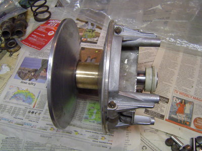

Removed the bronze bushing from fixed, and installed new one without issue. Waiting on a set of rollers, buttons, bushings and pins, to finish rebuild. "F" arms are installed in moveable, everything is snug.

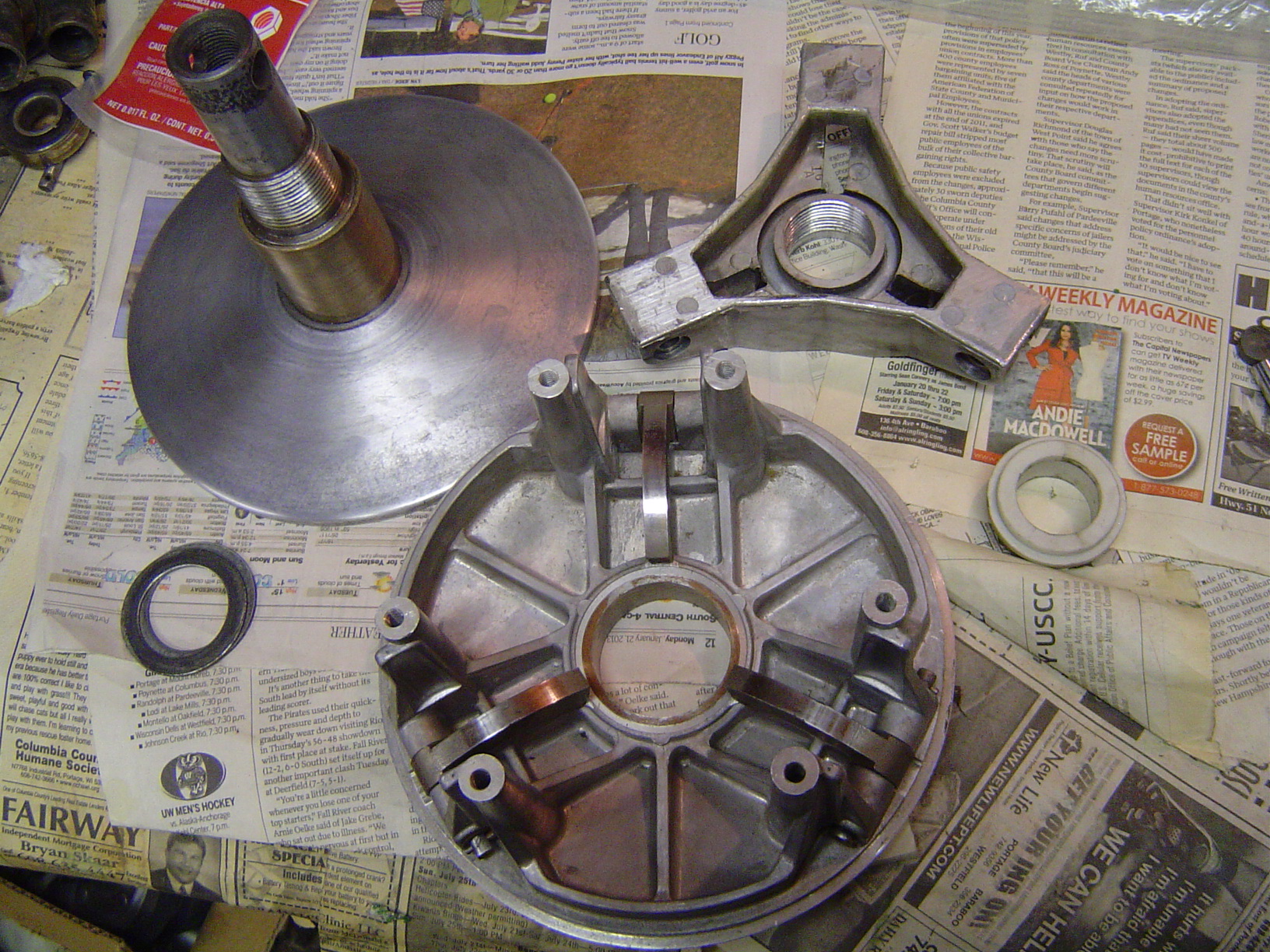

How did the rollers look?
Pins worn also?
Pins worn also?
Re: Let's rebuild a 101C Comet clutch
The pins and rollers must have been rusty or worn, because it appears I tossed them several years ago when I first disassembled the clutch.

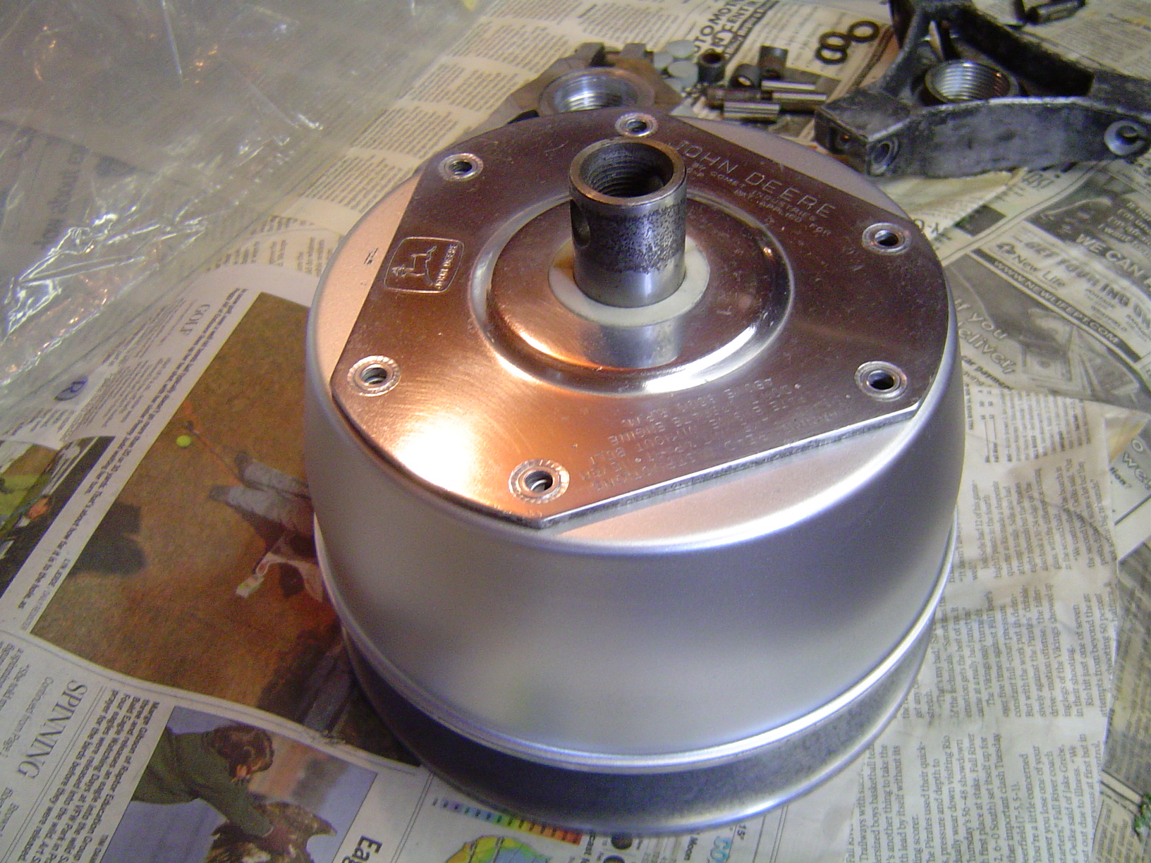

Got the roller kit from Randy today. It is installed, so all I have left to do is to polish up the cover, clean and paint the can, and final assembly can commence.

Ready for final assembly, all I need to do is find my tube of Locktight!

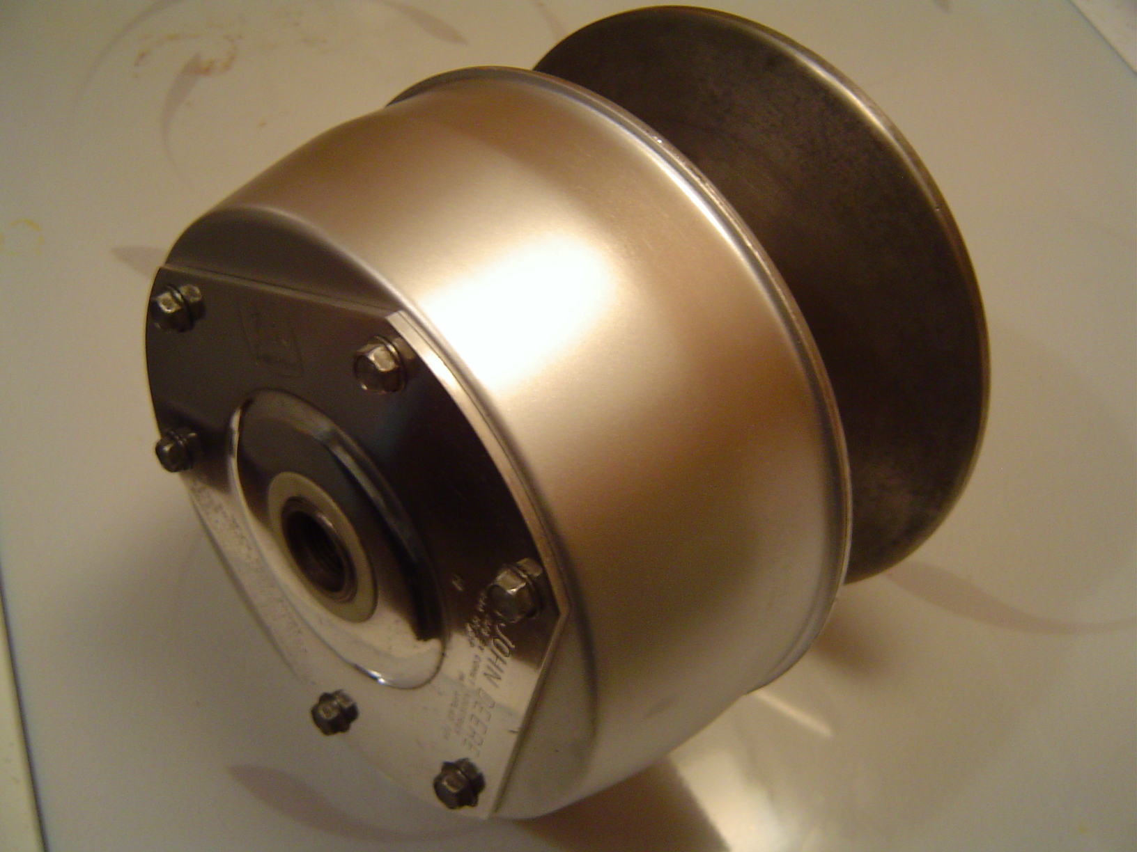

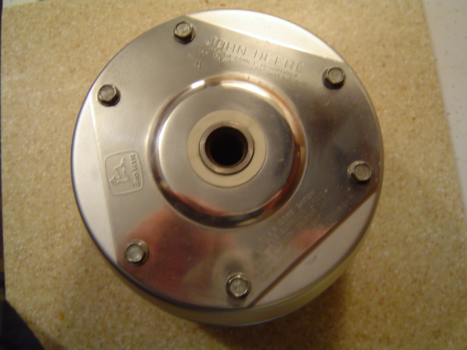

OK, the 101 is as good as I can make it. A few photos, and I'll move on to a couple of 102Cs. The bench is covered with Comet clutches!
