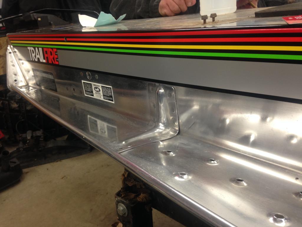

Well, I purchased a 1981 Trailfire in the middle of October 2014, and decided I wanted to make it a Project. My first snowmobile was a 1981 Trailfire I purchased in 1995. Many snowmobiles have passed since then, but something about that Trailfire was always with me. The looks I got when I hauled it 6 hours north and rode it in Minocqua for my first two trips to the Northwoods. The way it felt to have my own first snowmobile. I rebuilt a convertible I own about 4 years ago, and enjoy it, knowing all the work that was put into it. So, the sled has been totally torn apart. To date, I have stripped it down to the bare chassis. Fully disassembled the engine, checked the bearings, the cylinders, replaced all the O-rings on the crank, and put new crank seals and gaskets in the engine. The carb has been cleaned, checked, and all gaskets replaced. Hoping to have it all back together by Christmas.

Got my graphics in today from jdsleddecals and couldn't wait to put them on. Tunnel graphics went really nice. The hood graphics, I think I may have them a little low in the front edges on the sides. But still very happy overall. Can't wait to finish it and get it out in some snow for pics and a ride
