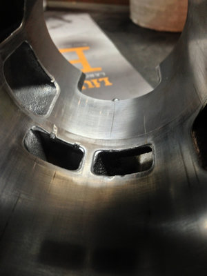

Here's a pic of the exhaust port. The engine was rebuilt bottom up. It doesn't look like a burn down, top of piston looks good, rings look ???. Perhaps a piston skirt? This is my buddy's sled. Not to sure what to tell him. He spent a bundle $ buying it. Yikes!
Re: 81 intruder locked up
Nothing to do now but to tear it down and see what happened inside. With debris on top of piston I would think it has to be melted. If that's the case then maybe the crankcase wasn't sealed up right, there was an air leak on the intake, carbs still clogged, jetting wrong, something like that.

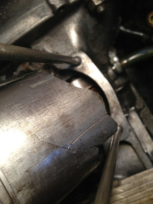

Here's what I found inside.
Both c clips are still in the piston. Too much clearance between the piston & jug wall?

Here's the piston up close
Possible causes: wrong spark plugs, premix ratio wrong, overheated-bad thermostat.
You need to split the crankcase and inspect bearings and flush out chunks of loose aluminum.
Ouch!
What happened first? Skirt failure?
Was the piston orientated correctly in the jug?
I think the skirt failed first. It seems to have a bit of play where the rod connects to the crank. Pison is in correctly i think, both cerclips in, no play in piston pin. The crank was replaced when rebuilt. Maybe 4 tanks of fuel since rebuilt.
