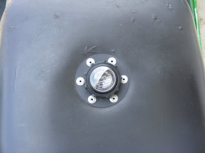

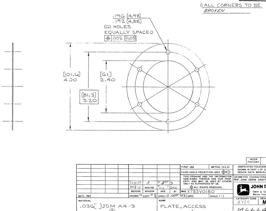

There is supposed to be a slight formed lip on edge of one and I did not do that. I just lasered them flat and this is what they look like installed.
