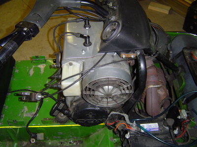

OK, so here is the situation: Rainville's X8 project got pushed to the back burner because of preparations for a baby that he inconveniently scheduled for February. I took a close look at my situation after Christmas, and concluded that while I have pretty much everything ready for re-assembly, I was not going to have time to get it put together and running before the RWTC weekend, at least it was a long shot.
So, I'm back to working on the green machine.
A different ignition has been installed, and the tin that Wade set me up with several years ago is installed.
