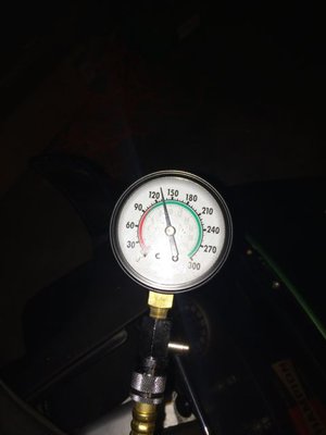

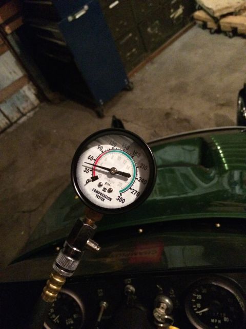

And, here is the results of the compression test. No real guess here... First picture is Number 1, and looks like about 132 lbs pressure. Number 2 is junk, and reading about 45 lbs.
Re: St. Hilaire Vintage run
Jason I think you were correct in thinking that you are needing new pistons.
We can't really see the tips of the insulators of the plugs, but what I see doesn't look extreme. But...the compression test does indeed tell the tale!

I am planning on doing a top end to it with new pistons, rings, and gaskets. It should be evident what the total damage was once the cylinders come off. The only thing I'm a bit nervous of, is did number 2 have a minor air leak which caused a lean condition. All seals and gaskets were done in 2014, since that's when the major restoration/rebuild took place. So theoretically, crank seals should not need replacing.
