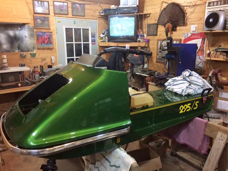

This is what Mean green Looks like from Dennis at Vintage paint. I am not sure how close it really is to the original, but I know I like it.

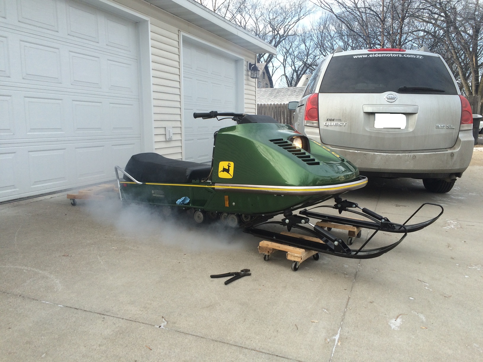

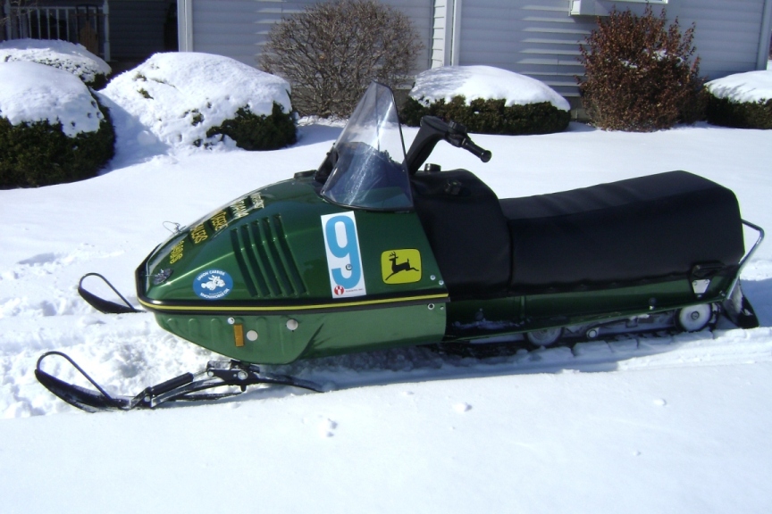

When I restored my first sled, a 77 Cyclone, I bought an NOS hood. Per my painter I took the hood to Sherwin-Williams in Fort Wayne, IN and they computer analyzed it to come up with a match. In my humble opinion it's the closest match except perhaps for Ddubs. The paint code is listed in a thread here on the forum. After painting the Cyclone we also used it for my 340/S. I'll attach a picture.
