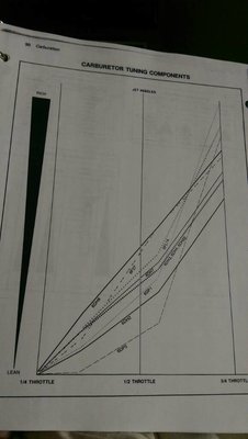

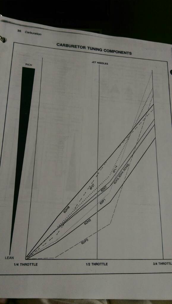

Here's the delivery curves from the fine tune manual. I'd be tempted to try the 6DH8 if I couldn't find a good used 6F27.
Re: Mikuni 6f27 needle
Wow.....that really messed up the photo resolution.....Let's try that another way.
