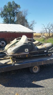

Like the subject line says. They really ain't a barn find. They came out of an old chicken coupe and I knew where they were my whole life.
These 2 sleds were my grandpa's. He bought both of them together winter of 75. The 75 JDX8 was new and the 72 500 was used. I was not around till 1977. So, yes I have a lot of memories surrounding these 2 sleds. I also have alot of work ahead to get them running again. Last time was 1996 and both didn't want to stay running so they got parked and left to time. Looks like I found a good place to learn how to fix these sleds up on here too.

Now, to get back on track here. It took time for me to get my shop built and ready for the items to fill it with. But I got them JD sleds home. This is the farthest they have been from the old farm since they were new. And that is only 100 miles away. I had the 20 year old layer of dirt blown off mostly on the way home. But a pressure wash was in order too. With the outsides cleaned up some, time to welcome them home in a nice comfy spot.
As for my goals with these sleds, I am just looking to get them running again. Carb cleaning and gaskets, cleaning the fuel tanks, new lines, and crank seals just to start. The X8 is first up for the treatment. Its in the best shape and only has 1409 miles. The track was replaced around 1984-85. I do believe it has less than 500 miles on it. I think my luck of getting it going for this year is best. The 500 has about 2300 miles and a bit worse for wear. I rolled it in the winter 92-93. I learned the hard way as usual that physics can suck. And being a dang dumb kid gooseing the throttle to fishtail the back end on an iced over road, can lead to you going backwards and hooking the snow berm where there is no forgivness. I was sore for a week, bruises all across my back from sliding across the road and frozen ice balls for about 25 yards. I figured I was gunna be dead meat for messing up that 500.. Guess Dad, and Grandpa figured I got what I deserved. They never really said much about it. So,, there it is. I will start work on the X8 and posting questions soon. Thanks in advance.

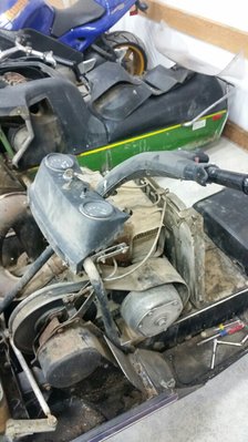

I don't figure to awful much in money will be needed to get that X8 up and going. Eventually I may attempt a restoration on it. But, I dunno yet. That's alot of money and time that selling would have no return. Though I prolly never will sell. I finally got to taking a few things apart before I order some parts. I am now into the the other 20 years of dirt too. lol
I discovered the drive belt of course is almost shot. And the air box is full of crud. But carb is open and free moving.
No telling though how long this lil guy has been in there. For all I know, he coulda been gassed 20 years ago since the exhaust is loose at the manifold and leaked bad from the bailing wire stretching.
Anyone know how to tell if the ignition got the update that I keep reading about?

Yes you have the ignition update on the X8. Just by the pics you have the cdi ignition which is the update from the original points setup. the big silver box upper left is the giveaway next to the coils.

I guess I must have misunderstood the posts where I read about the updated ignition. I had thought they just swapped in a different better box. lol. Oh well. I have good spark out of the coils any how. I even got a lil foggy and put a few drips of some mixed fuel in each cyl. And put the plugs back in. Pulled the cord and she came alive....... for 2 seconds.. good to hear that thing run after so many years. Even if it was so short lived. Pulled the drive belt too. I was thinking limp home belt. But, looks like it would shred instantly.
Speaking about the belt. I found the former one all over under the hood. The guard is missing so I can only assume the old belt took it out and the lower mount is bent down at the tank. Looks like I will fab somthing up for this guard. Don't wanna take out my tank. Anyone know if the guards used on the 00's the same as JDX8?

I have been tearing down the sled for the past couple days. And finding many things to address. I'm going to have to attempt to fix the exhaust manifold. It seems that it was rattling around so much because of the bailing wire was loose,,, it actually broke the end a bit apart,
If my attempt at fixing don't work I'll have find another one. Oh well. Yes, springs will be used when I put this back together...
