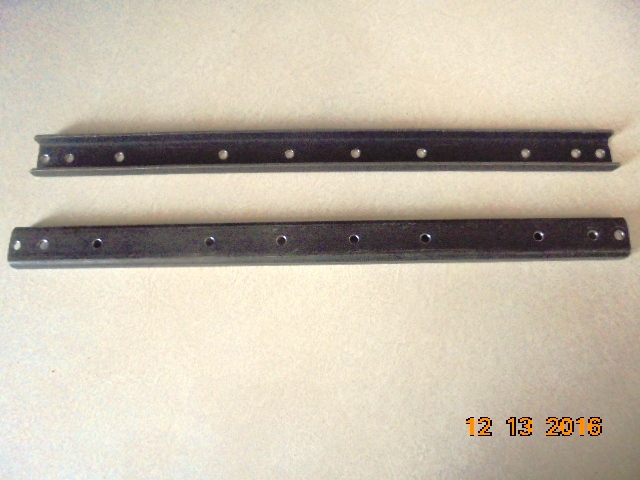

I have completed the task of making cleats for the Dator I'm restoring. I must say it is not a fun job and it's loaded with steps the way that I had to do it. That said I'm happy with the result. I will be taking orders for Dator cleats for a couple of weeks before I begin making more if needed. They are not inexpensive and will sell for $10.00 each. The price quoted does not included heat treating if so desired nor powdercoating. The attached picture makes the cleats look bent or something. The real things are much better than the picture.
