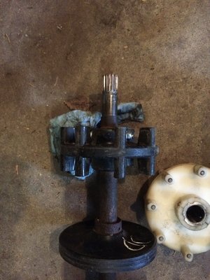

That is awesome to know it's an option, but I have a question Pat.... Did the splines on the drive shaft change from 75' to 76' sleds? The correct round shaft drivers I got for my 800 were on a shaft that looked correct, and I thought I would just replace the whole thing with the shaft I bought, but realized that the bottom sprocket wasn't going to fit due to the increased number of splines. So perhaps this isn't an option if you are trying to swap shafts into a 75' 800 or JDX8?
First pic is the original 1 1/8" round shaft and new drivers, and second is the shaft I got them from. Clearly two different spline patterns.
Re: 76 Cyclone drive sprockets cracked
Jason,
I am quite sure a drive shaft from a 76-84 front motor sled will not fit the 72-77 mid-mount sleds. As you noticed, the spline is different, and I think the length may not be the same either.
