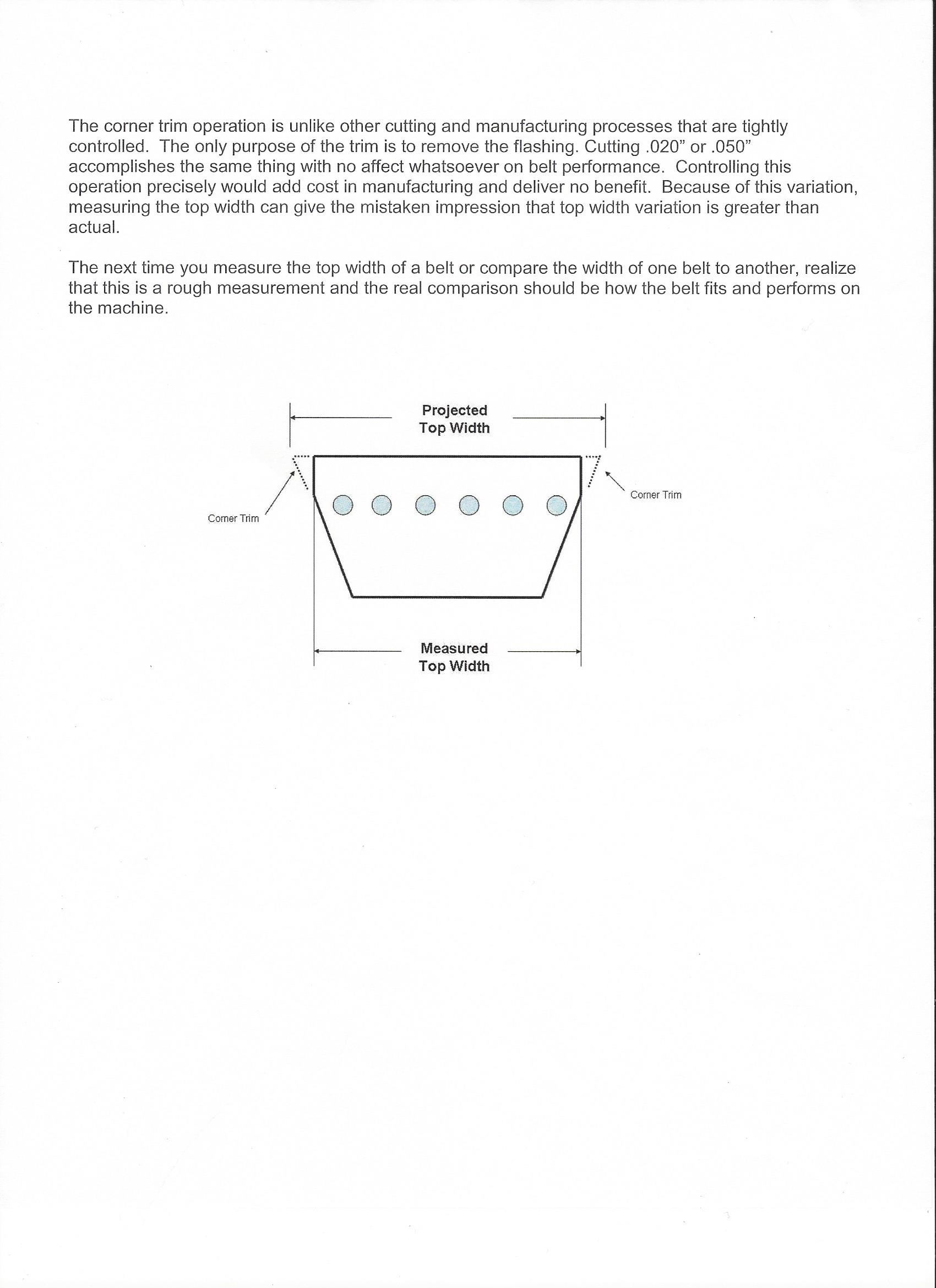

I received information this morning that indicated the MAX1135M3 belts were incorrectly sized. With that information I halted sales until I could establish the truth. With the help of Carlisle/Ultimax, Lincoln Huffman and Peter Duncanson we established that these belts are fine. I will attach a Product Information Bulletin from Carlisle/Ultimax that explains their products. What I had to remember was that I was comparing their belts with belts made 40 years ago. Technology has indeed changed. Also, being concerned, I stopped my order until I could find out the truck. As of now the order is back in the system and should arrive in a few days. Thanks for your patience and enjoy the attached Bulletin. Don

Good info Don! Especially for us geeks who wonder why stuff like that doesn't quite measure right when you check it.

Very useful info Don!! Thanks for posting. I wish the snowmobile oem's would make information like this more available to consumers,it would eliminate some confusion.

Not sure what your problem with the belt is but this same belt has been used on a Liquifire for over 300 trouble free miles. You mentioned in your email to me that the size was wrong, did you read the information from Carlisle? The MAX belt will NOT measure 1 1/4" as Carlisle removes the "flashing". Regardless of the problem I will be happy to return your money if you return the belts. There are a lot of customers still waiting on the belts.
