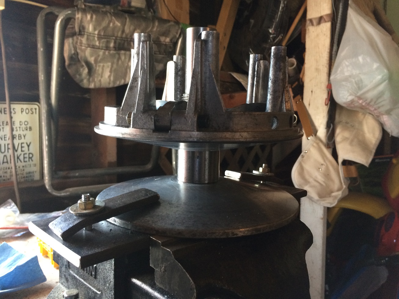

Since restoring my 75' X8, I've had a plan to rebuild a couple of clutches I have acquired. I installed a fairly nice 100c with new weights & spring, and it had recently gotten a new set of rollers & buttons. This clutch replaced a pretty worn out looking 102c which was on the sled when I received it.
I had been discussing this topic with Brian Linder for a while now, and reviewing his old threads on how to rebuild said clutches. So, like most of us, I've been stockpiling parts over the years, and started going through my bins to see what I had. Looks like I had all the correct kits to begin the rebuild of the 102c. I had finally gotten done building a holding tool for the fixed face. I did a mockup and gave it to a welder I know, who put it together for me. It's not an original thought as I had seen a guy do something very similar while rebuilding a Polaris clutch... don't reinvent a wheel if you don't need to.

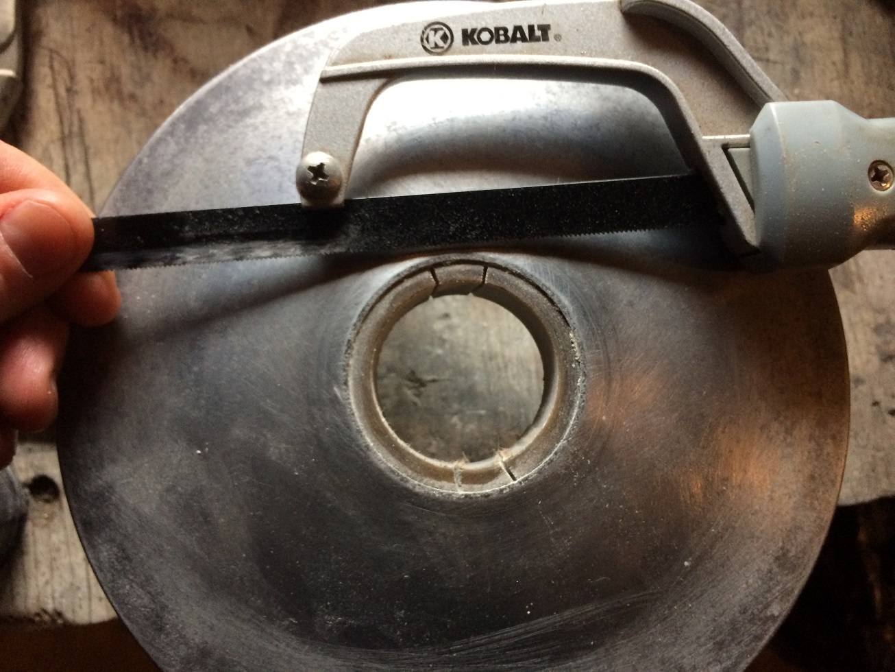

The next bushing proved to be more challenging. It is the larger bushing on the moveable face that is made of the same material. The difference is this one has a locking ring that sits in a groove. I originally was going to try and press this out, but Brian said that probably won't work due to the ring, which I agreed. So, the best bet is to try and cut a couple of sections out of the bushing and hit it with a punch to remove it in sections. This was done, but the bushing did not want to come out easily. (Comet bushing #204280 (NOS), replacement #204280A).

The next step is to try and get the replacement bushing in the face. The key is to try and hold the ring tight to the bushing groove so you can get it past the face in order to tap into place. I first tried a tape material that is meant for stopping leaks. This is a strong rubber material, but very flexible. Didn't hold tight enough. The next attempt was a zip tie of the right length to hold the ring. This did work. What I didn't know was how tight the bushing would fit in the opening. It went in good for a while, but started to bind up and I eventually mushroomed the end of the bushing.... Shot!
I think it is best if you can find NOS vs. the new replacements. I think that they have a better chance of going in a bit easier. So, found and ordered a NOS 204280. I also sanded down the opening more, and will maybe try a little heat next time. Hopefully better results. I will post again and pray for success.
