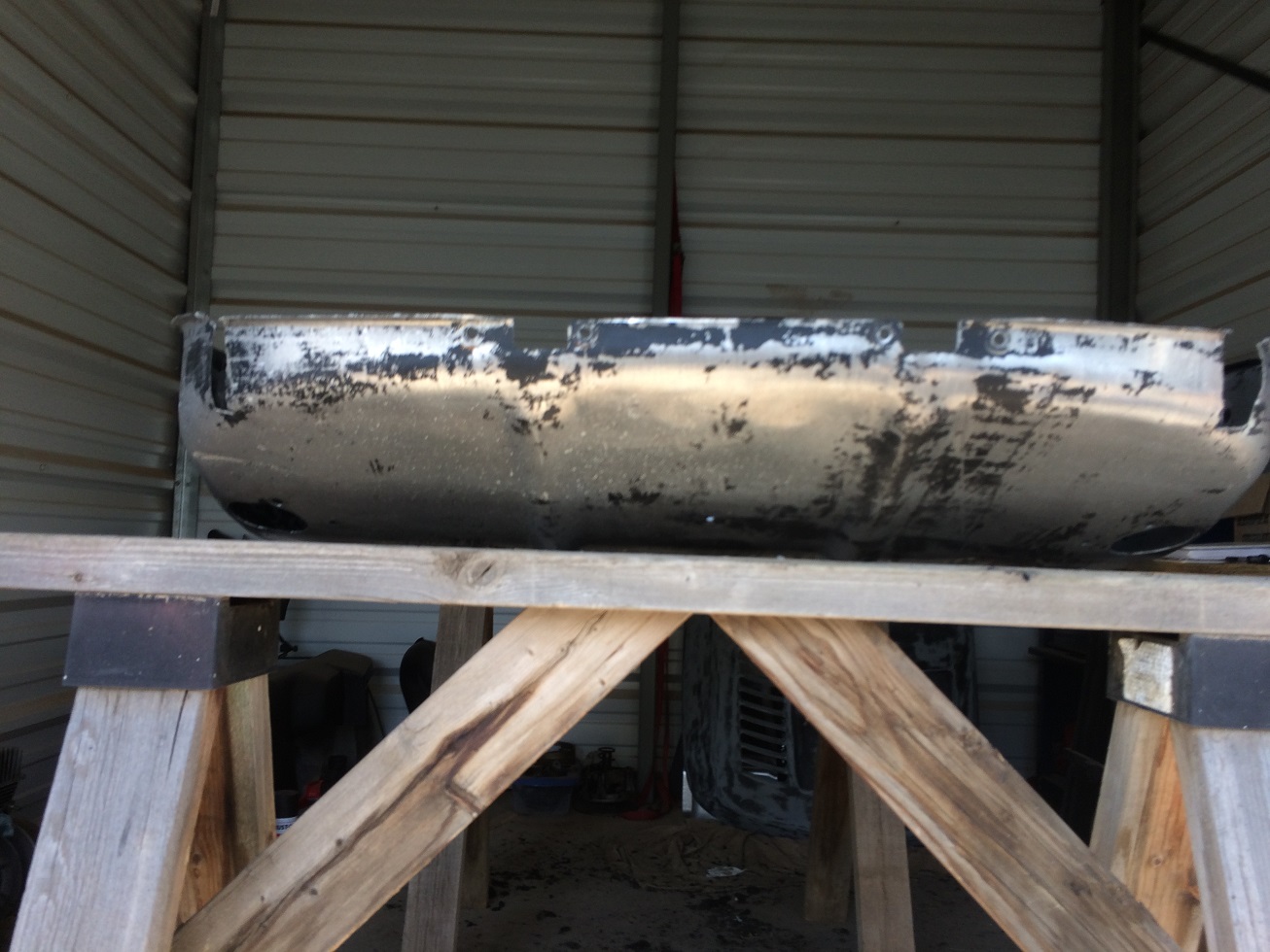

As for the JDX-8, after 3 weeks the chassis was finally done at the welders shop and could be picked up. They did a good job taking care of the cracks and a few spot weld pull outs on her.
Once I got her home I stacked her up to the first chassis I prep'ed and while they looked very similar, the pan the 'new' chassis is in much better shape. It was time to start drilling, grinding and blasting...
73 JDX-8 Chassis'
73 JDX-8 Chassis'
Welding Repairs
Welding Repairs

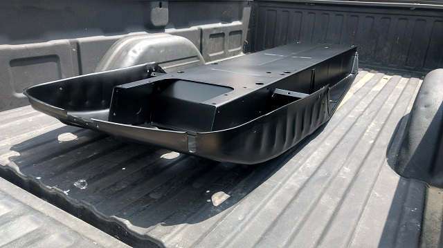

I got the call to pick up my 73 tunnel and a handful of small brackets from the powder coaters. I was please with both the final result and the $150 price tag for the work. After the HoF show the assembly work will begin...
