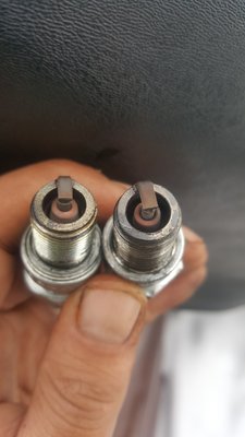

So I pulled these plugs out after a little riding mostly wot in a field. How do they look to you? 91 octane 40:1
Its a jdx8 with a Tillotson HD 14a carb
Rode it on factory HD settings of 1 turn out for high and low speed.
In the picture they are two different plugs as I tested one set then another to see the difference. Both sets look the same.

They are a nice tannish color which is what you'd like to see. So first indication is it's good. You should have the KEC 440/22 Reed Valve. I'm quite cautious with these because just slightly lean could mean disaster, but your plugs look pretty good. I'm just guessing, but the one on your right is likely the Mag cylinder, and the one on the left is PTO?
Question: What plugs are you running? NGK BR9ES? Champion RN2? Also, what gap do you have them set?
How did the top end feel? Was it pulling like you think it should have, or was there any part of your throttle range that seemed lacking in power? Just curious. Does your idle setting seem correct now?

To be honest I forget which plug came from which side.
They could both be from the same side, I tested two sets of plugs this is one of each of the sets both looked the same
I'm pretty sure the right one is a br9eya and the one on the left is a champion rn2 or
