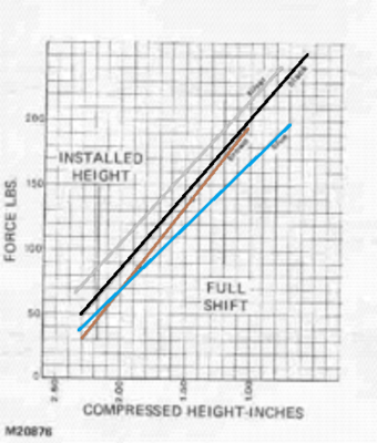

Springs ---
Black spring Tension at 1 1/8" - 198 Black spring Tension at 2 3/8 - 50
Silver spring Tension at 1 1/8 - 190 Silver spring Tension at 2 3/8 - 85
The black spring has a lower initial spring tension at 2 3/8" So it will engage sooner.
The silver spring has a lower spring tension at 1 1/8" So it will hit full shift sooner and at a lower rpm.
What the springs are doing is setting the power band. A shim will shift the power band up but the slope will stay the same. (see chart)

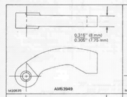

Weights
Weights are a bit more complicated. They control the rpm between initial engagement to full shift.
Now a F and an U weight have a very similar profile with U being heavier.The heavier weight will get to full shift sooner. Which will put more load on the engine. Ideally you want to be at full shift by peak horsepower.
There's a lot more to weights if you want to get into it.
F weight
U weight
AJC

I want to point out a correction needed for the previous info.
The correct cam arm for Serial NO. 70,001 and up
Both 340 and 440 Cyclone,AM54279 which is stamped "R"
All the clutching info is for Altitude of Sea Level to 2000 ft.

Also, new F weights are available, they are just called F-2 now. I think the difference being that they have the bushing (plastic?) inside the weight where the pivot arm slides through. They should be the same weight, but they give you that range of + or - .75gr. I got a set at Pat's Small Engine for $18.00 plus shipping.
