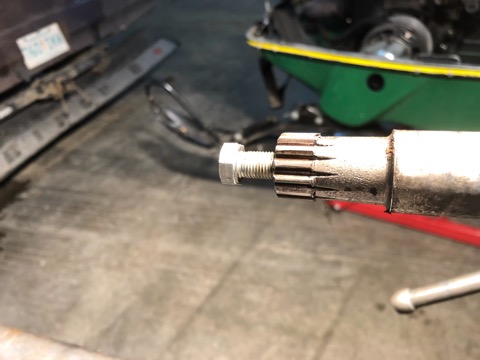

The disc is wobbling so much on the shaft that it is pushing the brake puck back and I have to pump the brakes every time I use them after driving the snowmobile. I Pulled the shaft and plan on getting the shaft built up, does anyone know what the tolerance is between the shaft and the brake disc hub?
Appreciate any suggestions to solve this problem .
Thanks Glen

For a class 2 “free” fit, the clearance on a 3/4” shaft is approximately .001-.003”.
