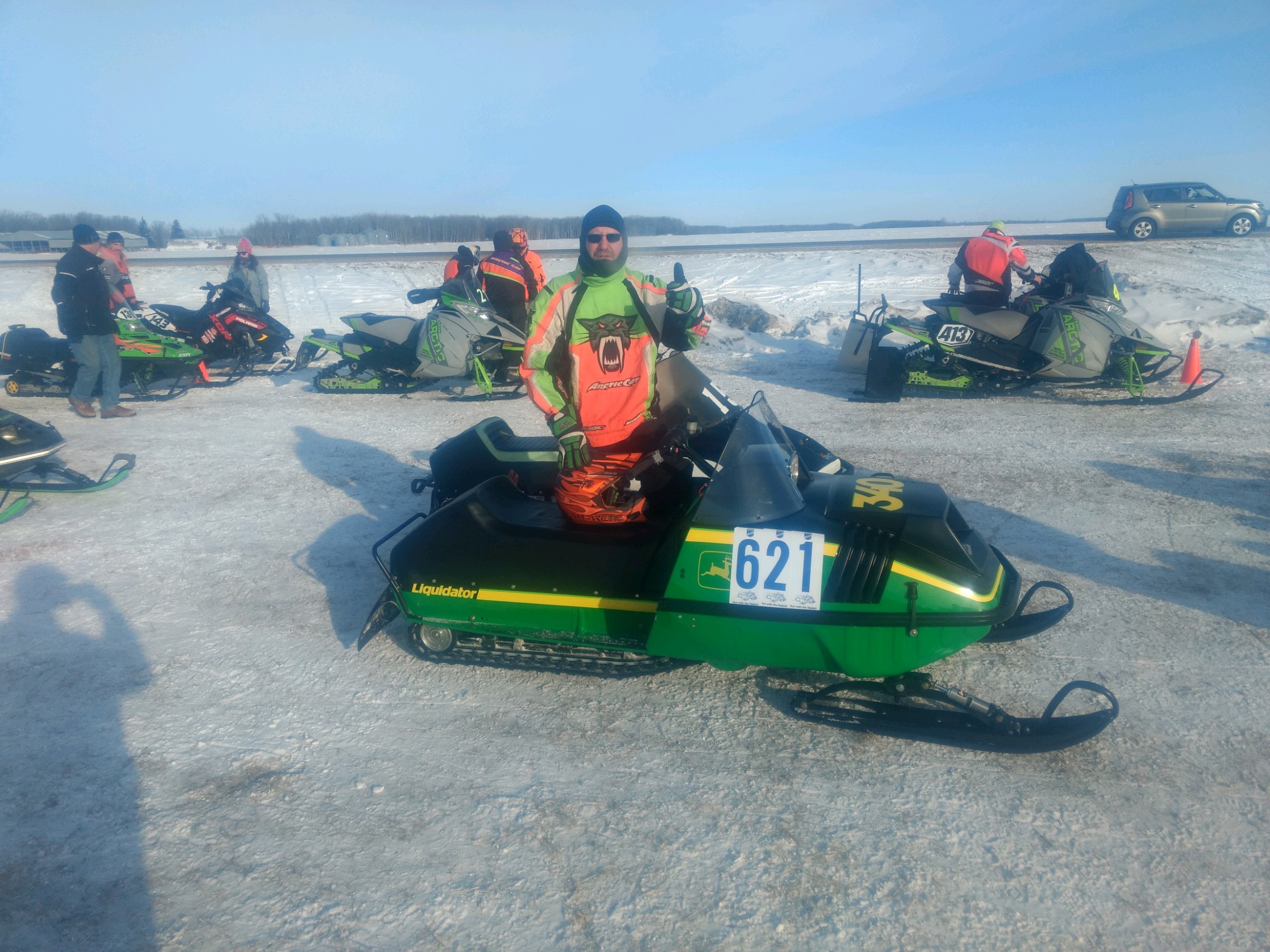

In a short recap of last year, Adam and I built a real Liquidator out of a very rough chassis and loose motor parts because as Adam said: "you need to do this". The sled came out looking great, especially considering what we started from, but it was basically untested and the calibration was not spot on.
On the positive side, the sled handled and rode well, and it was a fun 10 miles until she quit on the river. In an ironic twist, I let Adam run my old Liquifire as punishment for building my Dator, and he finished with it. Go figure.

After completing the 150 mile vintage challenge, Adam had me return the sled to his shop where a full post mortem could be performed. Due to a slight scuff on a cylinder wall we had them nicasiled over the iron bore, new pistons coated and installed, and everything re-checked.
To make sure timing and fuel were on, I flew up to NY so we could dyno the beast at Dynotech in Batavia, NY. This was an excellent experience working with Jim Czekala and his instrumentation. Unfortunately we found the Aaen pipes did not help with the power, but were able to make adjustments to gain some of it back. The important part was that we were able to dial in jetting and ignition curves so the motor ran strong while we monitored the air/fuel ratio and listed for knock.
This will help take a lot of guess work out of clutching the sled knowing where the power peak is for this engine. So with some suspension, motor and clutching updates, we are going to line the Dator up at the I-500 for attempt #2 with this sled. Adam should be racing something too.
