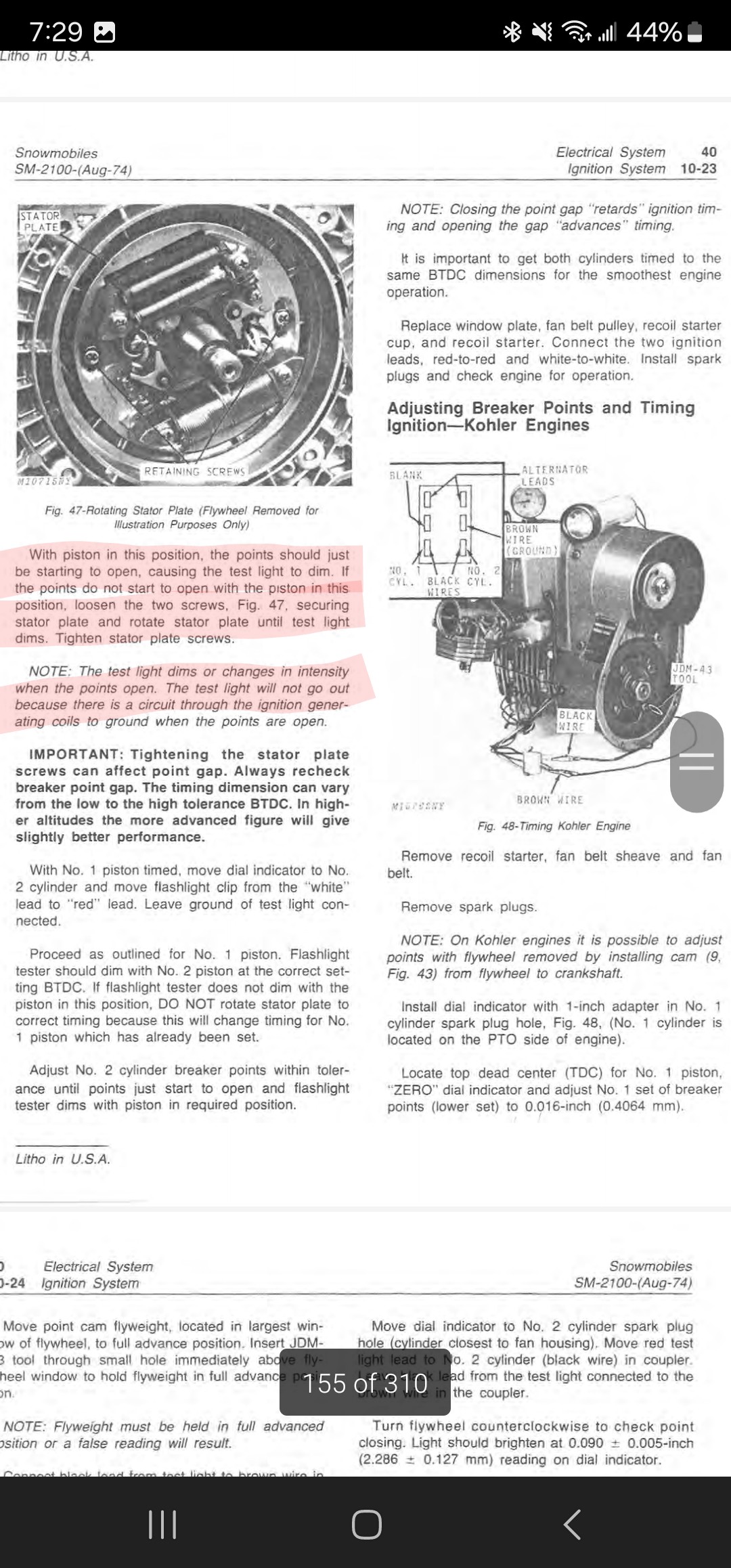

It's a ccw 340 from a '72 400.
It's the manual with 310 PDF pages... Service manual SM 2100 from '72 Deere's serial numbers 2551+
Edit: found it again. Page 153 of the PDF... Section 40, 10-21.
Looks like I set the timing but NOT the breaker points. Yes, appears breakers need to open to a max spec of .014 inches (3556mm)

I've been fiddling off and on with this. I've got the points adjusted to open at the proper depths, but I can't rotate the stator "enough". When I turn counterclockwise as the manual states, the corresponding points close, like you said Steven... Not open, like the manual states. Am I mixing up my terms here?

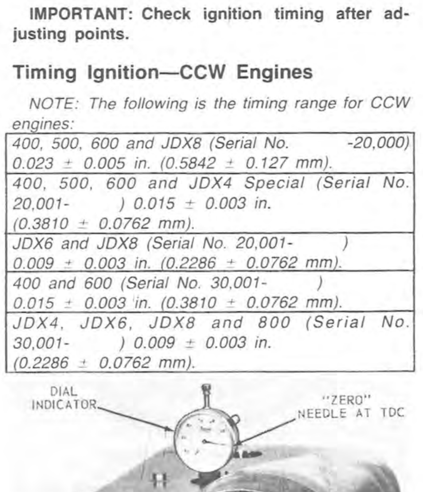

Is the position of the piston for my 400 supposed to be .023" as read from my dial gauge (yes, I'm in the first SN grouping on the chart)? That would mean I've been interpreting too much verbiage and not enough of the tolerances provided in the manual.

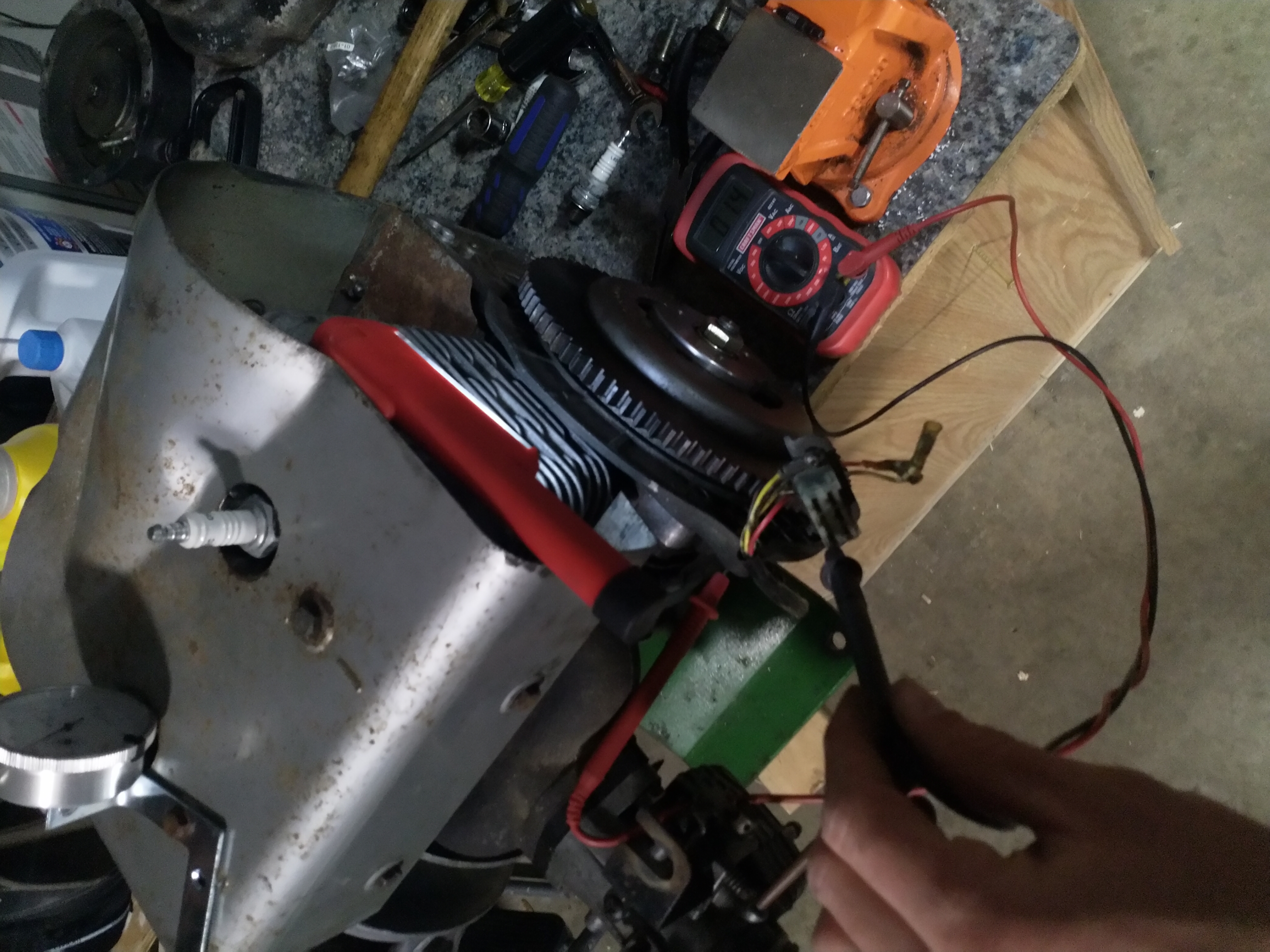

The answer is a resounding yes. I've been doing the timing wrong and now it all makes sense. I'm able to hit my point gaps and time the engine to .023 from tdc.
Once I buttoned up a bit and pulled the recoil handle the spark I had from the plugs was the best I've ever seen from this sled, so I was hopeful. I put it back into the sled, ran it to a can of fresh gas, and primed and pulled to start over and over. Once I was about to give up and tear down the carb she sprang to life and didn't even give any indication of wanting to die out. I'll need to adjust the carb for sure.
For reference, here's a few photos.
Impact driver removes nut, this scrap piece of angle from the box store holds it so I can torque it (leave your handle longer than mine)
Overall setup

I'm still messing with this thing... It very well could need new coils, but I want to make sure it's firing when it should. Manual says to find TDC, rotate counterclockwise to specs listed on chart. My specs are .023" +/- .005. Am I supposed to rotate it only .023 (green line) or to .023 (blue line)? The red line indicates as far as I can go before the points close (by rotating the stator), so I can't actually make it to .023". Unless I'm reading the dial gauge incorrectly. I'm using a multimeter Ohms setting to find the exact point that they close (again, currently the red line).

For what it's worth, Brian L explained in a FB Group how he sets them. It's a dance by trying to get both points open the same amount (as measured on each cylinder at TDC) and to have them hit at the same time, which for this engine should be .023". I'm positive I had this correct the last time I did it...

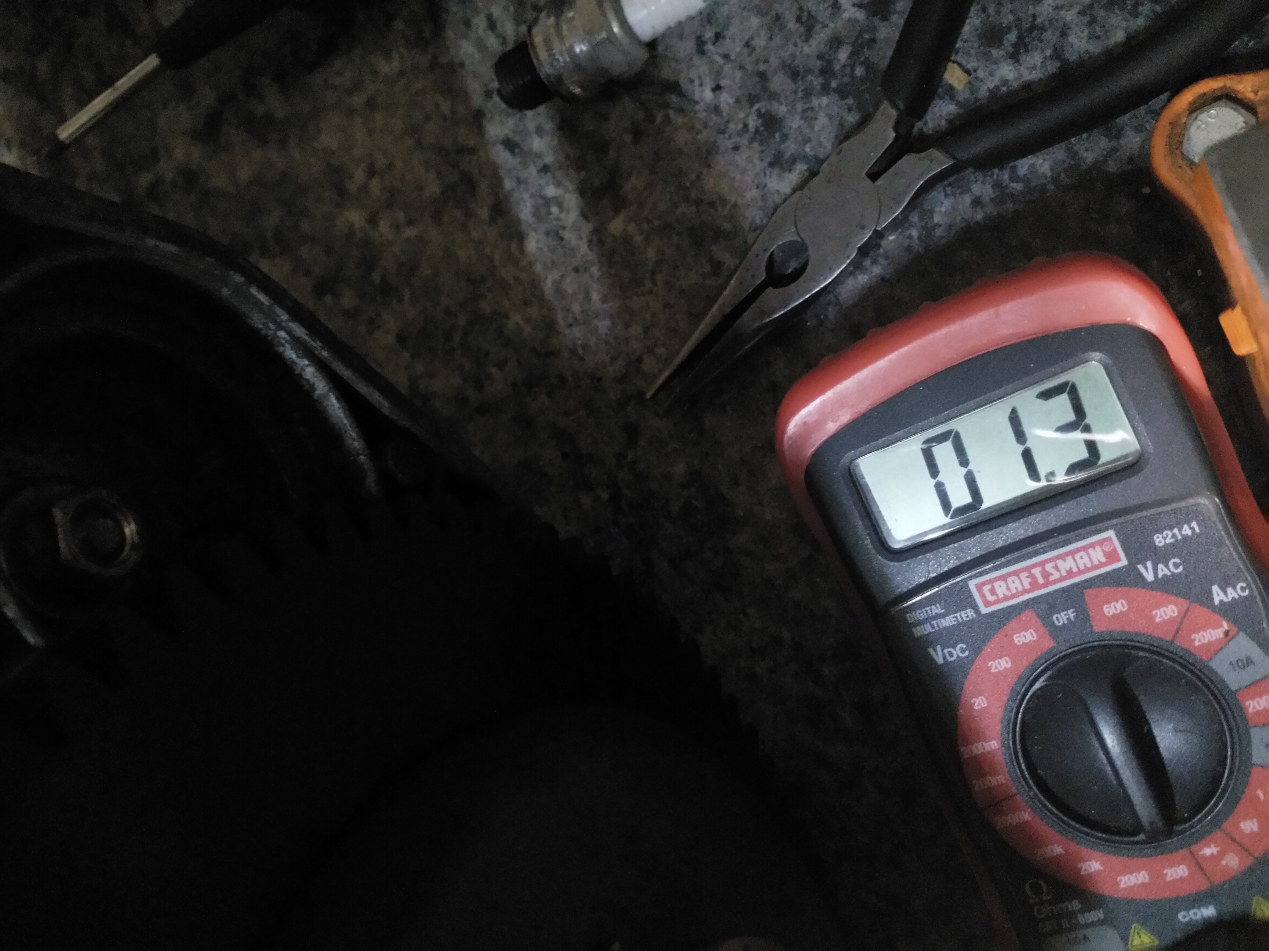

This time, while measuring Ohms (because I don't have a flashlight tester and haven't made one), I was getting some inconsistent readings on cylinder one. As I was rotating the flywheel back and forth and the points were opening/closing, sometimes the ohms would stay at 1.3 or 1.4 when it should have been dropping to .2 or .3. With that suspicion, I tightened the flywheel, had to readjust the points again, then put the recoil back on. I had a solid spark on cylinder 2, but cylinder 1 was good for 2 pulls and then no more spark. So I think I have a problem with the condenser. I'm going to try to source one and see what happens.
