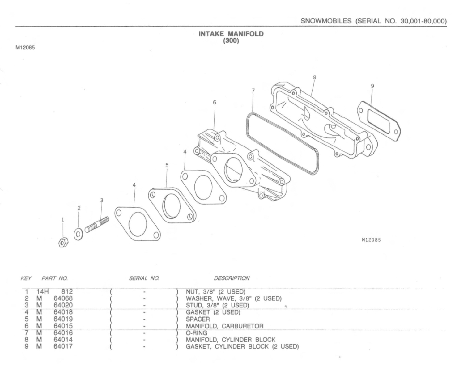

Hey guys,
I’m trying to find the o-ring in the picture number 7? Anyone know where to get one?

No one that I have been able to find still make that, But I took my part over to a hydraulic place and they found a o-ring that fit pretty good. I dont have a part number as that was a while ago.

Thanks,
I guess that’s what I I’ll have to do.
I found out today that you can go to NAPA and they sel o-ring different sizes by the foot and they sell a type of glue that you can weld the rubber together too. So might just make my own.
