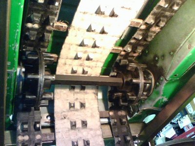

double check that you have the bearings oriented in the correct position. The wider part of the bearing where a locking collar would normally go has to face the spline end of the shaft.
When you get it in, it should look like this.
