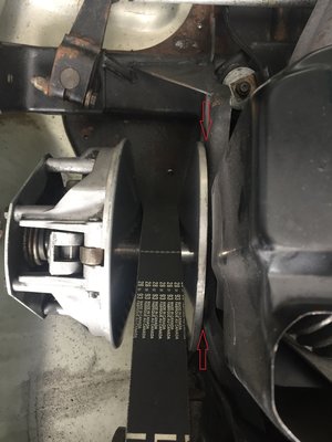

I recently rebuilt the 440 and now have 26 miles on the rebuild. I am slowly working out all the bugs on this sled and having fun doing it. I noticed the clearance between the primary clutch backing and the vertical framework that the crankshaft passes through is very close. Probably 1/32" or less!
With the drive belt removed I can rotate the primary clutch and do not feel or hear it making contact with the vertical frame. However, I can hear the primary clutch ever so lightly make contact with the vertical frame when I have a good load on the engine, like towing a sled etc.. I pulled the primary clutch off and sure enough there are small scuff marks on the backside of the primary clutch and I can see 2 areas on the frame where the paint has been scuffed off by the primary clutch.
Don't worry the crankshaft end isn't grooved or stepped. The ridge is antiseize. That's my fault as I applied antiseize to the crankshaft when I installed the primary clutch.
I tried loosening the 4 engine mounting bolts and tried pulling the engine to the left to increase the clearance. I found out that there is no adjustment right or left by loosening the 4 engine mounting bolts. I also tried loosing the engine cradle bolts and pulling the engine to the left. Once again there isn't any right or left adjustment of the engine. The secondary and primary clutch has been aligned using the JDM-81 tool. Has anyone else run into this situation before? I am tempted to remove the primary clutch and smacking the vertical frame brace with hammer and piece of wood to push it toward the center of the engine compartment. I would smack it right where the two little rub marks are. By the way, I do have the snubber installed and it is set per the book at .035" clearance and the primary clutch bolt is torqued to 50 -ft-lbs too.

It sounds like the crank shaft is to far to the mag side. There is retainers that go on each side of the crank shaft to prevent side play. Just my guess.

So here is what we found out. The Comet 102C Clutch (Incorrect Clutch) that was on my 81 Trailfire can't possibly be the correct one. This sled has has had numerous things done to it by the PO and this is another to add to the list. I have been systematically undoing what the PO has done to this sled. As I said earlier the backside of the clutch was making contact with the frame when the engine was at full load. John went and measured the clutch to frame clearance on his Trailfire and my measurements are nowhere close to his measurements. I even measured the distance from the PTO crankshaft seal to the end of the crankshaft and compared that to another 440 Engine I was given. Those two measurements where the exact same so that ruled out a crankshaft alignment issue. I also mentioned to John that I happened to have another Comet 102C clutch that was off a Trailfire 440 that I received in trade for some liquifire parts. John recommended that I install it and see if the clearance was better. So I did and the clearance was way better
In fact the Clutch to Frame clearance was now very close to what John had measured on his Trailfire. So I removed that primary clutch and compared the two clutches side by side to see what the heck was going on here.

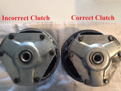

These two Comet 102C clutches are different!
Here's the differences:
The face plates are different. The stampings are a mirror image of each other and the one on the right doesn't have any patent numbers.

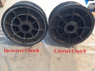

The wall thickness of the hub bore of the correct clutch (Right) is thicker too. Also the radial castings on the back side of the clutches are different. The clutch on the left has a U-Shape where the radial lines intersect the center, the one on the right doesn't. Rminier you are right about there being different offsets!

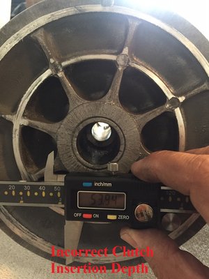

I measured the insertion depth's of each clutch. The correct clutch has a longer insertion depth than the incorrect one. The measurement was taken from the end of the tapered bore to the outer edge of the bore. The difference in the insertion lengths equates to 0.38"! That's a significant difference! The clutch bore tapers must have different angles too since the incorrect clutch slides down the end of the crankshaft further even though it has a shorter insertion depth.
