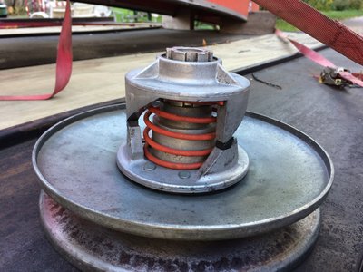

Can anyone identify this secondary clutch model and tell me how to disassemble? I need the change the buttons but can't find any instructions.
Re: Comet Driven Sheave
Came from '76 400. Primary clutch is Comet 102C.

Info for this particular sheave was actually found in the '75 service manual for the 00/JDX series. It has the two half moon clips and is different from the Cyclone Sheave and the one shown in the '76 manual.
What I encountered were burs/ridges on the shaft teeth above the clips, presumably caused by metal on metal contact. With some effort, I was able to remove the clips but the burs prevented the helix from coming off. To fix this, I put one clip back in to hold the helix down, then carefully ground the burs off with a dremel tool and a tiny grinding cone. I ground one half, spun the clip around, then ground the other half. This allowed the helix to come off. Once the helix was off, I carefully ground and sanded the remaining burs, replaced the buttons and put the thing back together.
Took more time to figure out what was wrong than it took to actually fix it.
