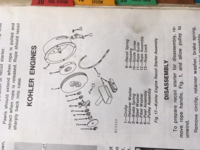

The next thing on the list for the JDX is trying to find some new motor mounts. Not sure, but I would almost think they would be somewhat universal. Any ideas where to find them would be appreciated. I am also in need of a pawl assembly for my recoil. I have a diagram of the parts schematic. but no part numbers.
The part I need is #6 pawl assembly. I have 2 recoils and the pawl assembly is broke on both of them. Not sure if the recoils could be interchanged with the CCW???? Sorry for the sideways view.
Thanks for any info.
Randy

Re: Motor mounts/recoil
The pawl assembly part number was originally AM52544 it subs to AM54674.
The motor mounts are available after market.
I sent you a PM.
I sent you a PM.
