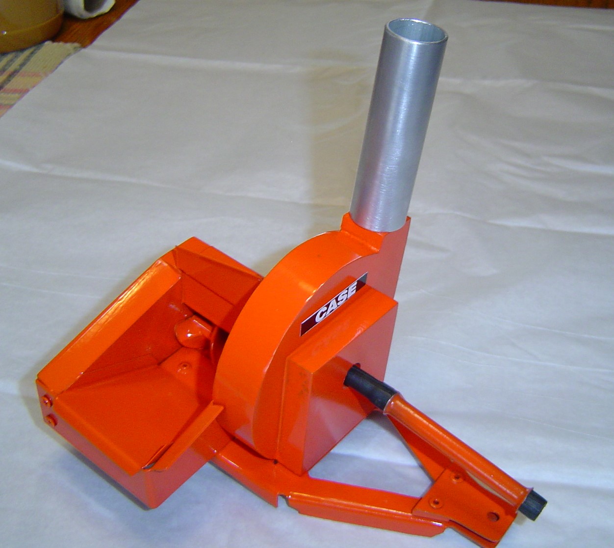

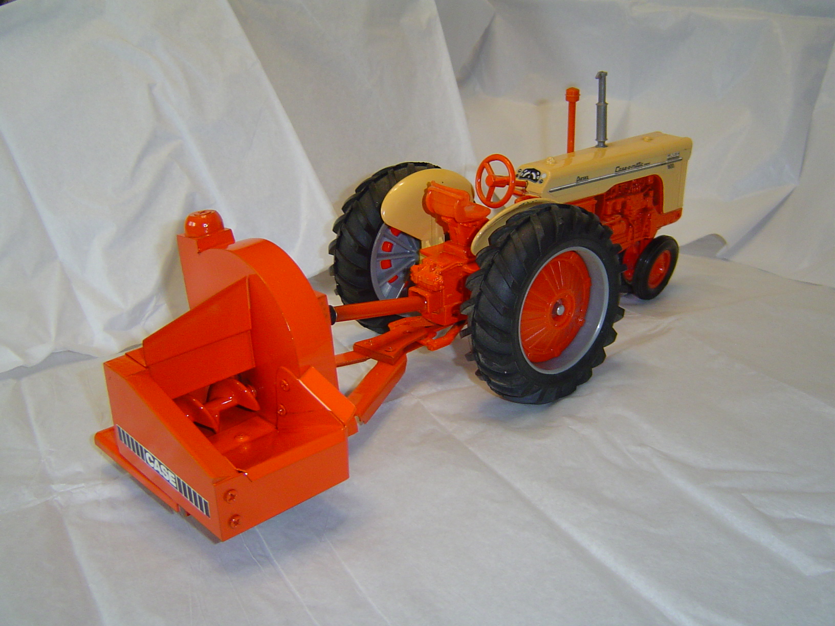

When we built the farm set for the grandson for Christmas, one detail that I included was a fill pipe up the side of the silo. By the next day, he was telling me that he was going to need a blower. I looked into that, and it appears that no one ever made a 1/16th scale forage blower. This meant that grandpa was going to have to build one!
Around the farm, I had access to a late model Case-IH, an old IH, and an old JD and Case that was built by Kools in the 70s. After looking at the 4 designs with an eye towards replicating then in 1/16th scale, it was obvious that the Case would be the easiest to build.
I had been thinking about this ever since Christmas, and a design slowly began to take shape. I took extensive measurements in March, and began collecting parts and pieces. The frame would be bent up out of .040" aluminum, and the rest would be a mix of pine and .012" aluminum. The hardest part was finding wheels that I liked. I finally got some plastic wheels with bearings that were for a 3D printer, that were the size I needed. I couldn't find the period correct decals, so I had to make do with decals from a 1/16th tractor from the 80s.
As always it was a scramble at the end. The toy was painted the night before his birthday, and the decals put on just before we left for the party. :bonk:
He was very happy with the result.
