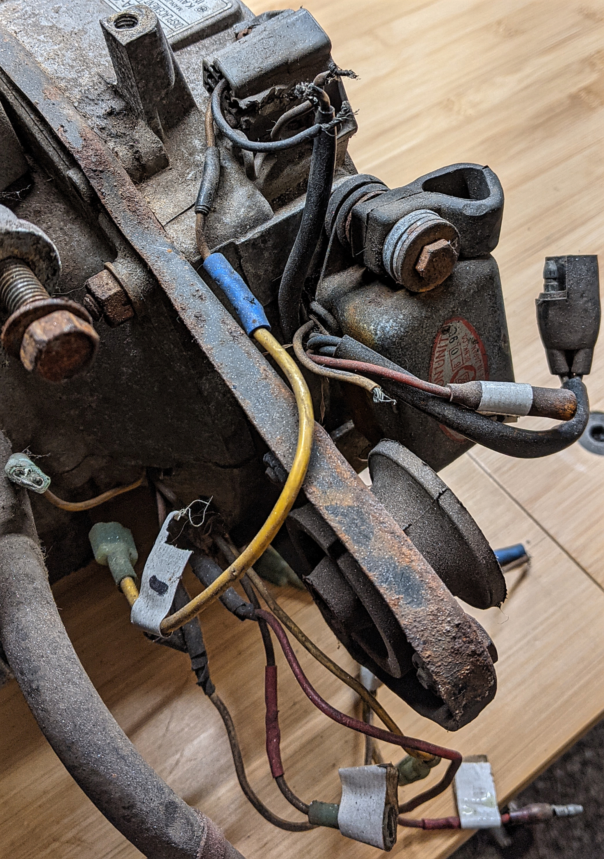

The electrical is looking pretty sketchy too....

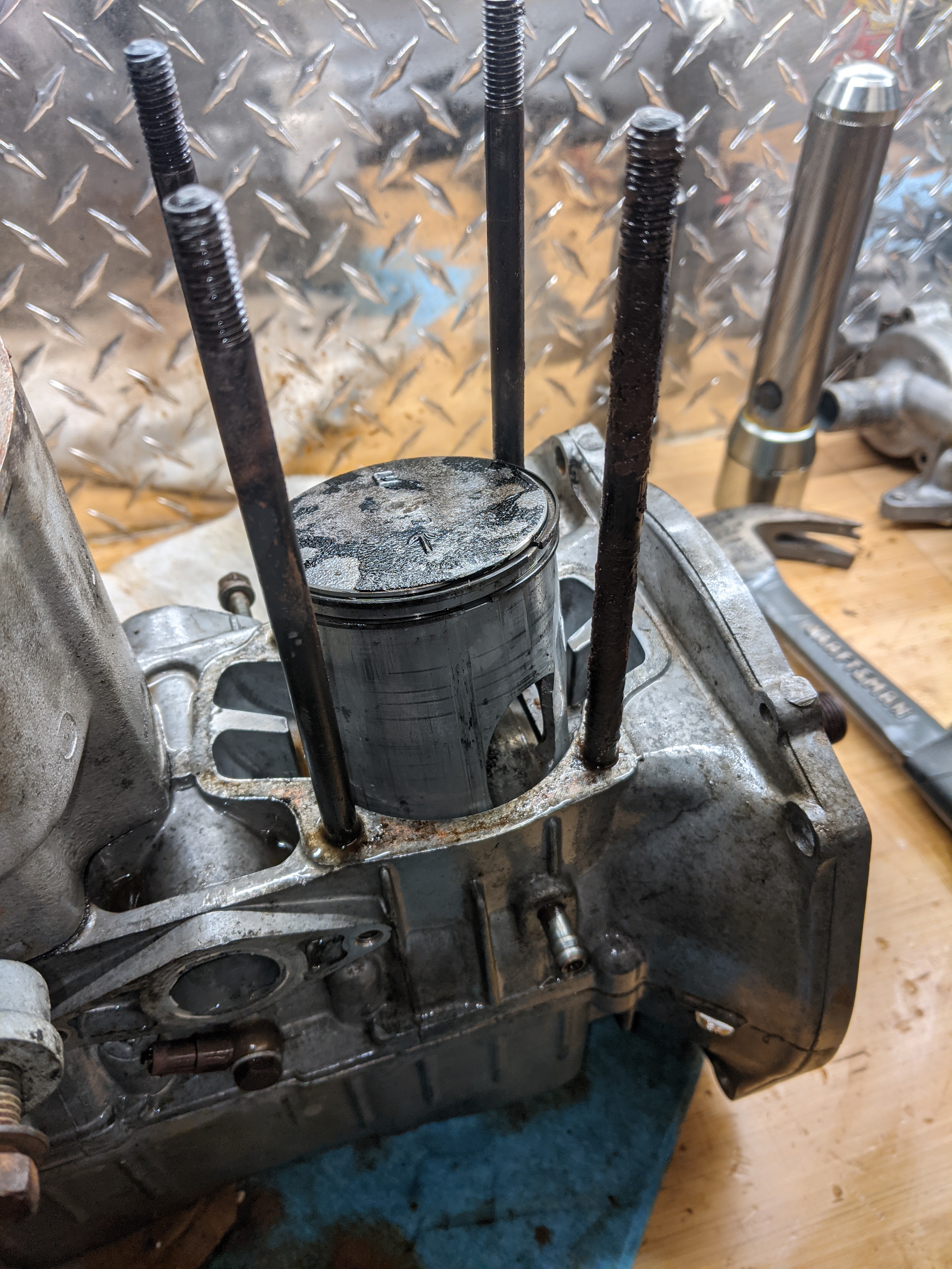

Was able to tear down a bit more tonight. Engine studs are pretty frozen, so there's been some work getting this apart.

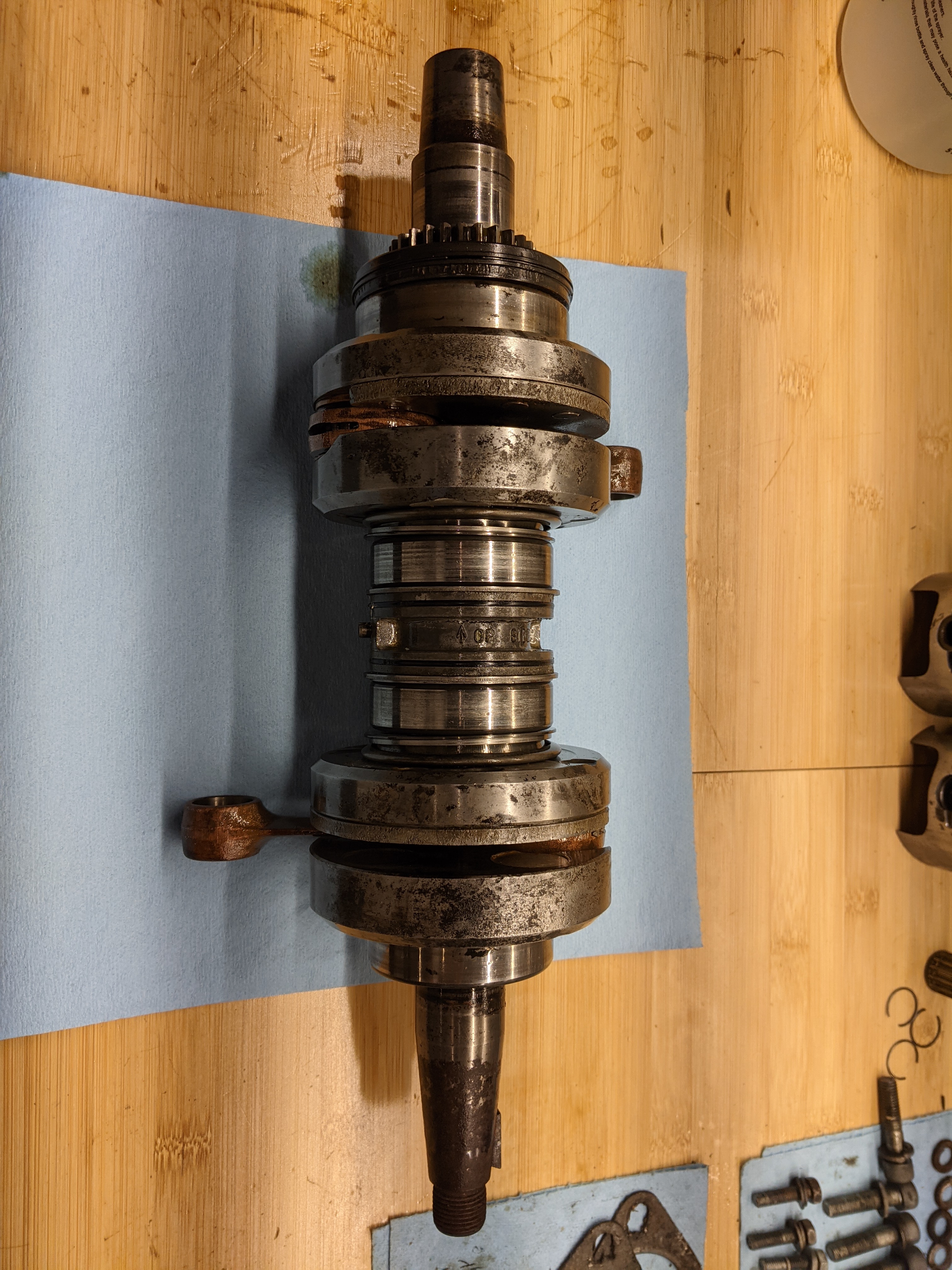

I got everything tore down finally. It appears one of the Parts Unlimited pistons (09-689) lost its skirt. Surprisingly, the top end is intact. The crank bearings are smooth, but the center labyrinth seal is cracked. That usually means junk.
I sent some pics over to Jerome at Crankshaft Services to get his thoughts on the matter. I will report back....

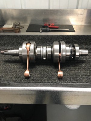

So, Jerome finished rebuilding the crank. Waiting for it to be shipped back, but here's how it looks...
