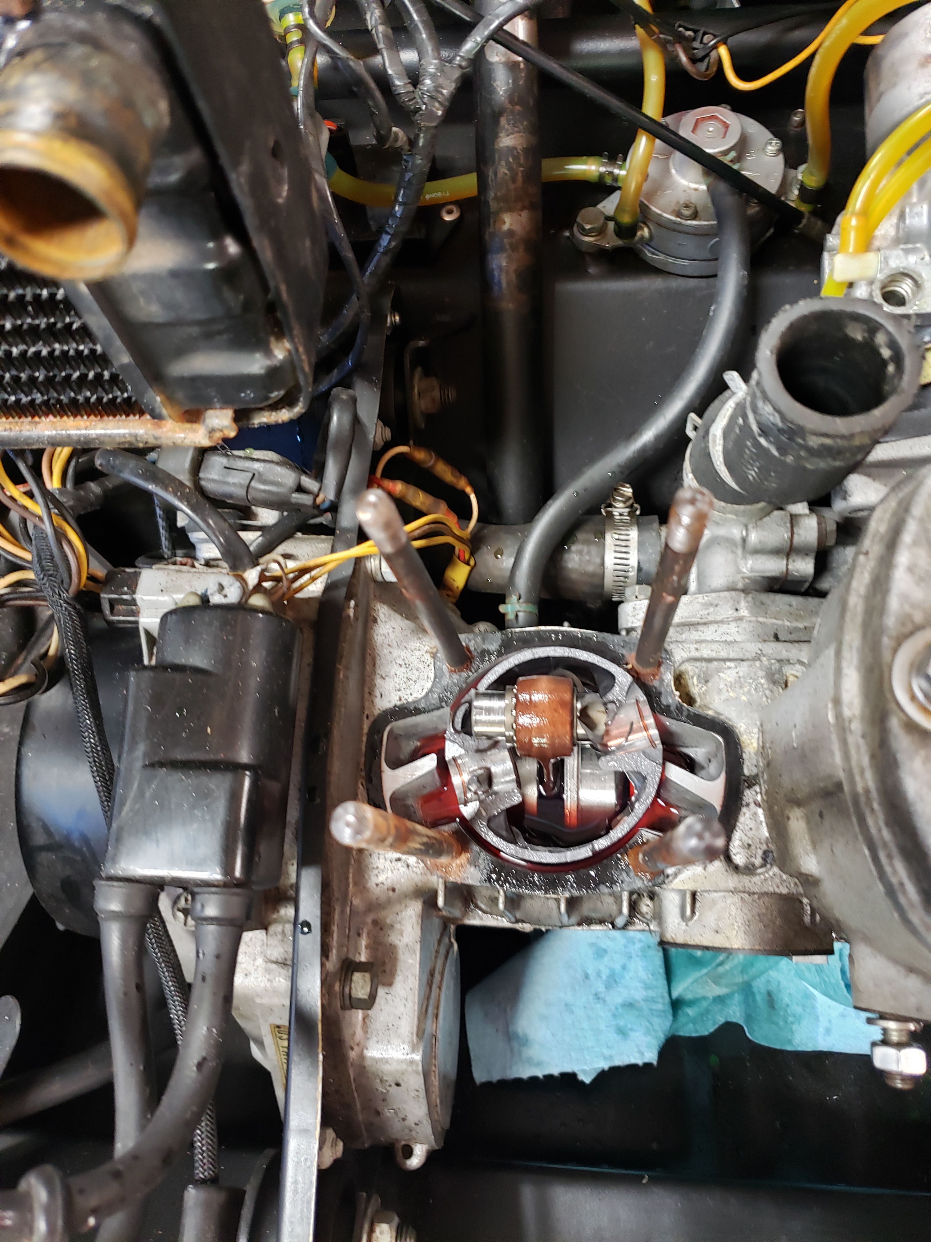

I've actually been wondering if Klotz is part of my issue. Part of the reason I made the switch to Klotz was how well it flows at lower temperatures. I've been wondering if that has a negative effect at higher temps. You're luck you got away with just a broken pull rope. Last fall I split a piston in half when the motor hydro locked (I'll post the photo if I find it). The thing that shocked me was how easy it started. It never pilled hard, or gave any warning, started on the second pull. I actually thought to myself "that's the best it's ever started after it's summer slumber", then about 3 seconds later "bang".

Here's a photo of the carnage

So I've discovered the Liquifire hasn't been discharging oil after sitting a couple days but the crank full of oil has apparently blown a head gasket. Overflow bottle fills instantly upon startup!
