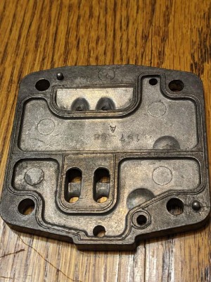

The first time I tried this carb on an X8, I quickly found I had fuel spraying out of one of the upper plates that has a vent opening out the side near the impulse fitting. So it went on the shelf for a while to think about what it had done.
I recently pulled it apart and looked at the plate in question. I didn't really see anything wrong with it, but there had to be a reason for why it was leaking, so I pulled out the magnifying glass and took a closer look. I quickly identified a couple of places where the sealing rib that is molded into the plate was deteriorated. There seemed to be a break in the rib near the dogleg at the top of the plate in the photo, and another between the two halves. I believe this is referred to as the fuel pump plate, and being as the one side is vented, there shouldn't be any fuel on that side.
I have a box of junk carbs on the shelf, so I picked out a couple of the same plates and cleaned them up and then took a close look at them. Pictured is the one I decided to install.
I recently put the carb on a X8 and tried it again. The fuel spraying out the side seems to be resolved. As I write this I am still in the process of getting the metering arm set correctly, I'll post the results when I know more.
There is a lot of talk around the snowmobile community that the square bottom Walbros are junk. I tend to disagree, but I will acknowledge that 50 year old carbs in many cases have degraded. I suspect this is why some of these carbs just won't work correctly. Recently I am hearing the same thing about 50 year old Mikunis as well, so it isn't just the Walbros. Everything thing we own is busily trying to oxidize it's way back to base components, ie. ore!
So besides thoroughly cleaning the carb, and scrubbing off any corrosion, I suggest taking a really close look at those plates, and make sure that there are no breaks in the ribs that may be allowing leaks inside the carb. I assume you will notice any leaks to the outside. A properly functioning Walbro is a beautiful thing. They allow for easy fuel mixture adjustment to compensate for temperature. Keeping one on your mid-mount allows you to keep the original air box in place. Swapping it out for a Mikuni is not a cure all, just a different set of problems.
