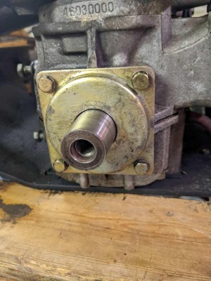

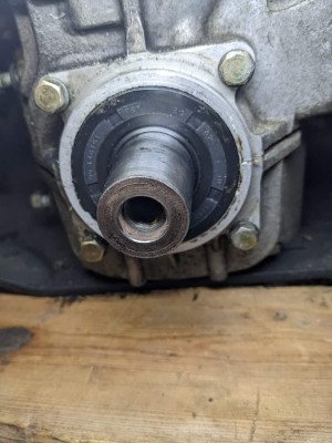

Crank seals going in. As you can see they needed to be replaced.
PTO side first, clean up the shaft, the case opening, a little lube, a little sealant, and wrestle that bugger in there!

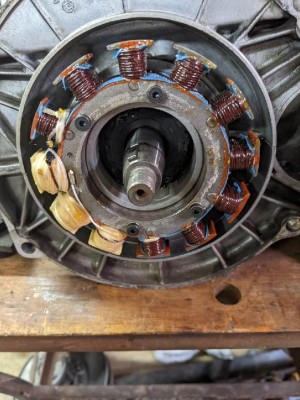

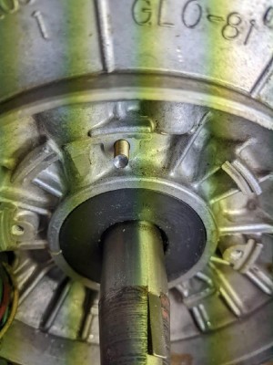

Mag side next.

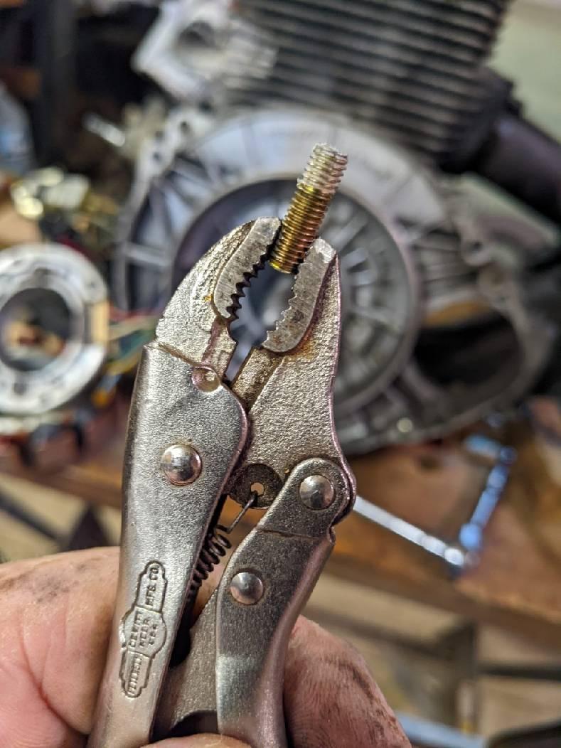

Philips head screws were messed up. Stator screws came hard, trigger screws were way worse. Heat got 3 out, but the top screw stripped out. I drilled the head off, got the trigger off, put the heat right where it needed to be and turned it out with the Vicegrips. Socket heads will be sourced for re-assembly.
Always an adventure.

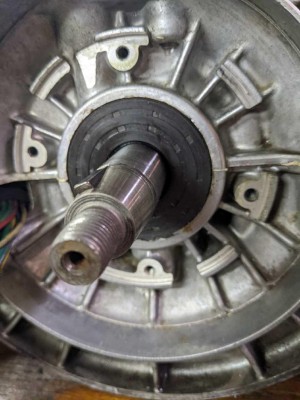

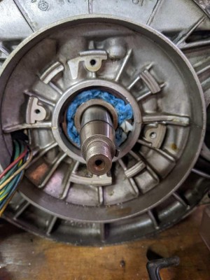

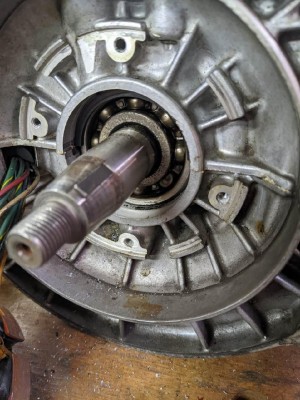

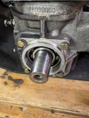

Mag side seal is out and the clean up begins.

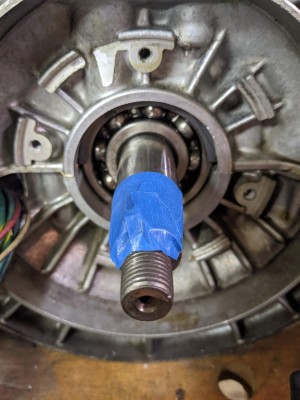

I pack a strip of oil soaked paper towel into the bearing to keep the grit out. Then I degrease the shaft and polish it with 600 grit. Clean the case opening and remove any burrs found.
I give the bearing a squirt of 2 stroke oil, put a bit of tape over the key to protect the seal, and give the shaft a film of oil. I put a bit of sealant around the case opening, oil the seal opening, slide the seal over the shaft, then tap the seal into place. For whatever reason, these always seem to go into place much easier.

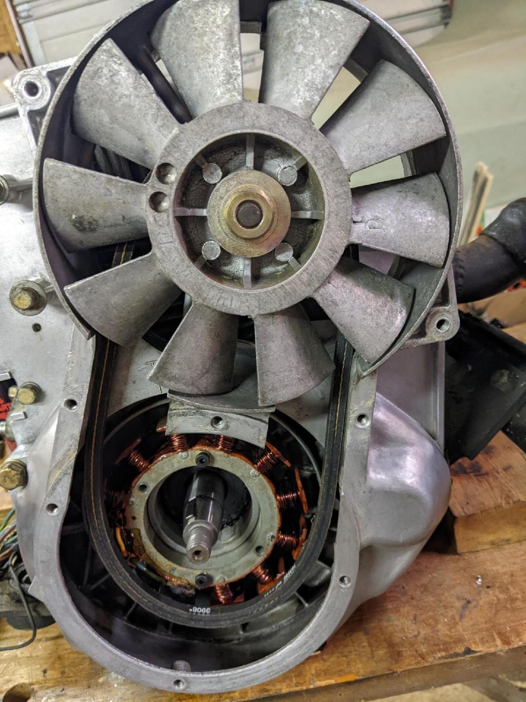

On to fan bearings!
These fan towers are always so nasty looking! I have sanded them smooth and polished them, but when you get them cleaned up you find they are fairly rough and there are a lot of imperfections, so it takes a lot of work and then in the end they really do not polish up all that nice, at least that is my experience. I have soda blasted them, which takes off the oxidation and brightens them up, and that seems to work very well on the cases, but leaves the towers lacking. I want it to look like new, whatever or however I think that looks. Well it is too cold to any soda blasting anyway, so I cleaned the worst of the gray fur off with 220 grit sandpaper, then worked it over with a maroon Scotchbrite pad. Hey it's better than it was.
The new bearings are in, they haven't been fully seated in t he pic, but I did remember to put the spacer in between them! Just need to source a new fan belt.

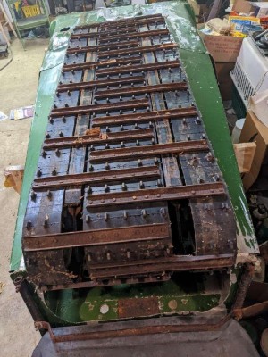

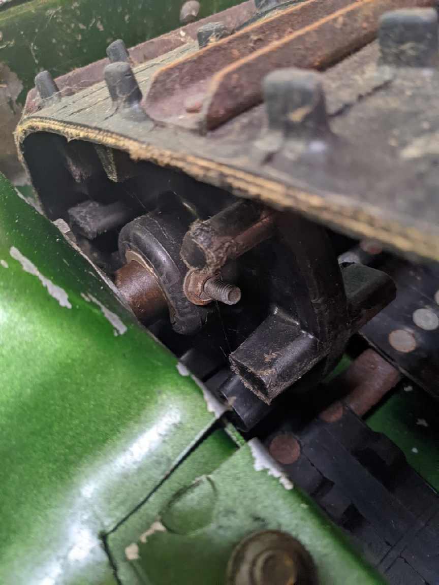

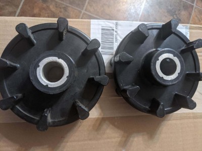

We got the Cyclone rolled on her back on Sunday. From this angle you can see the typical dead center impact damage that seems to required.
I was surprised to see that the sled already has black drivers on it! The 2/3rds cleated track looks quite serviceable, with a few dinged cleats, but not too bad.
Note the O-ring sticking out of the bearing!
I am still thinking of installing a 78 suspension along with a 78 cleated track that I put some picks in years ago.
In for a penny, in for a pound.

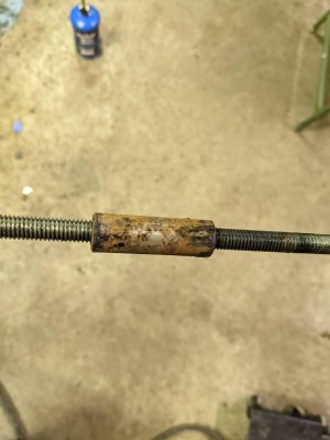

Pulling spindle bushings. This tool works the best of any method I have tried to date.
Pieces include a piece of 3/8" redi-rod, a length of thick wall tube, and a recycled bushing.
The real benefit here as that you can apply tension to the part, then apply heat or persuasion via the BFH.
I did warm this one with the propane torch, which normally doesn't get things hot enough to help, tapped on things lightly, made sure the puller was wound tight, then put a socket over the nut on the end and added the persuasion. You will know it has moved when you can tighten the puller more. A little PB Blaster can't hurt, and the bushing was out.
This one wasn't rusted bad at all, others I have done required the oxy/acetylene torch, and red hot to break the bond. These bushings need to be greased and free to turn in the spindle. Once seized, the bolt turns in the bushing, or the spring saddle begins rocking on the bolt, none of which is good.
The tube I am using here is longer than it needs to be, because I use the same tool to pull suspension shafts out of the tubes.

The o-ring looks impressive.
I've always found that setup a little odd. I get it but the oil can still leak past the clearance between the bearing and drive shaft.

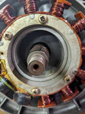

The Cyclone got side tracked as I got ready to go to ERX, then after we got back I got sidetracked putting a set of plastic skis on the 73 X8 before we headed up to St Germain for the RWTC.
The Hewtech stator is installed with socket head screws, and the recoil starter got the gray fur polished off and installed. I purchased several belts, and wound up installing a 10A685.

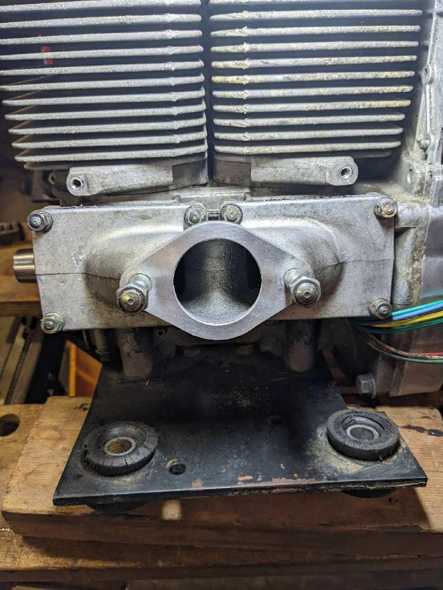

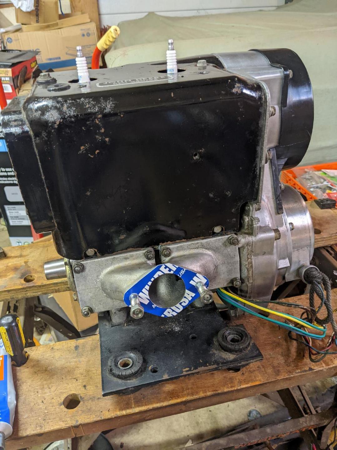

The intake manifold studs were messed up, it appears that someone cranked SAE nuts onto the metric studs. So after some consideration I decided to swap the entire manifold out. I have never messed with reeds before, but being as I had cracked the manifold off, I figured I should go in all the way. So I took it down to the case, cleaned everything up, and reinstalled it all.
