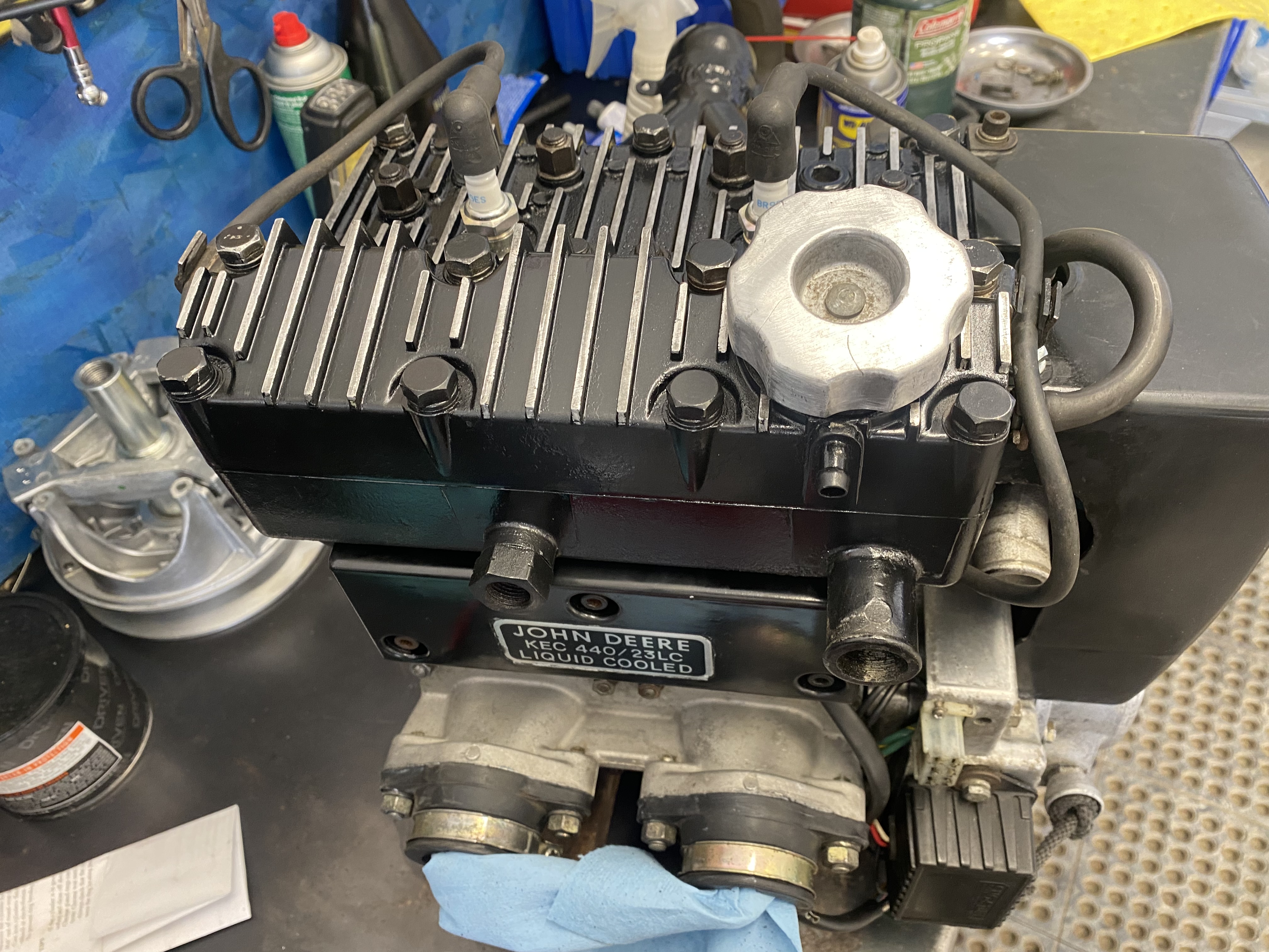

Well guys i had to open up the 440Lc to clean bottom end and reseal. Shes all back together and doing some minor chassis repairs before I install. The only hiccup i had was one new piston had a smaller groove cut on top ring land on left piston. Spi pistons. Ended up using the old ring which actually fit. The bottom ring was fine. It had good compression when I took apart but i had pistons so thought what the heck. Also found a waterpump cover with minimal damage.

Post by Popcorn popper »
Shined up the fins. Thinks it looks better.
