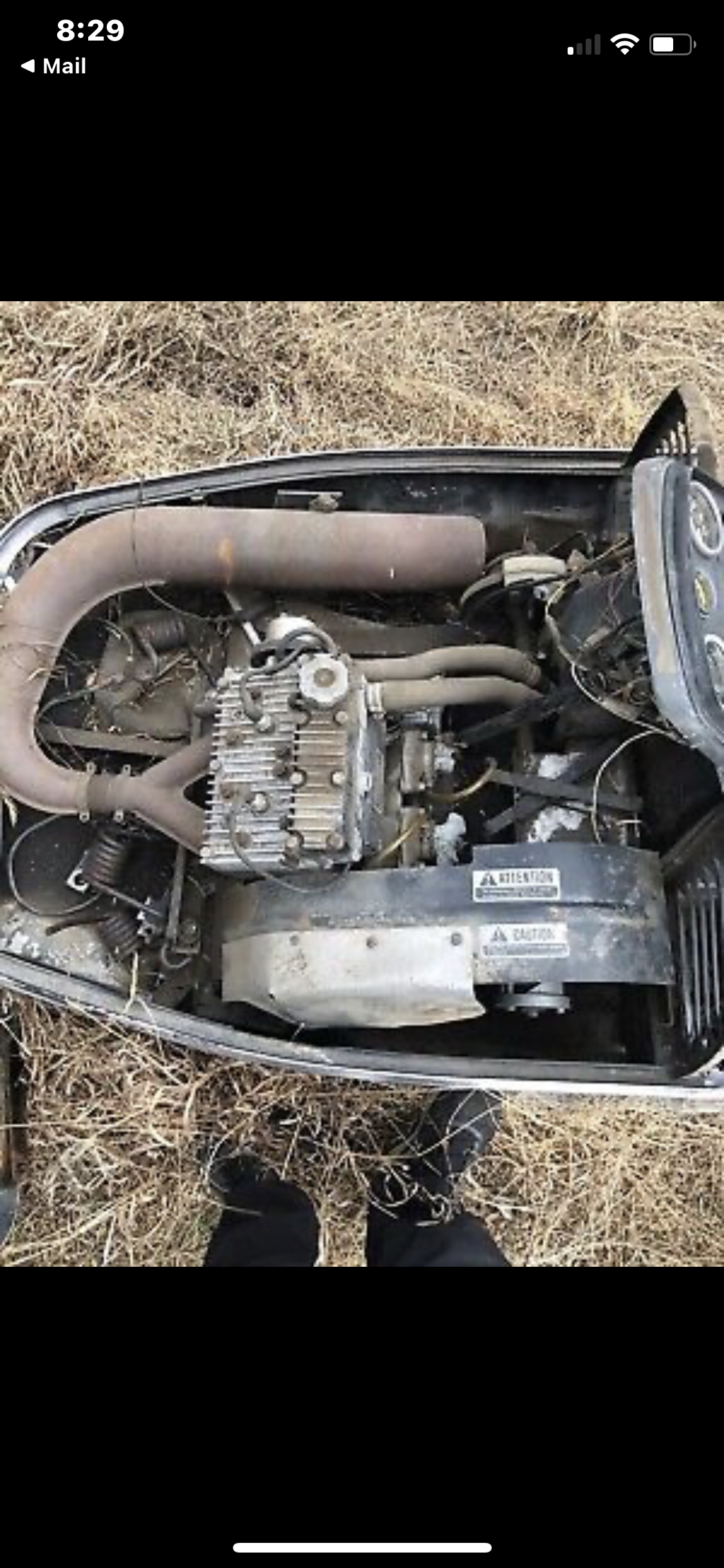

Guys i found a parts sled. It doesn’t have the cooler under hood for engine. Was this a option. Its the second one I’ve seen this way.?
Re: 77 liquifire
Glad you got that figured out!
I’m not an expert on the Liquid sleds, so someone else would have to comment on that.
- Posts: 225
- Real Name: Steve
Re: 77 liquifire
Ok thanks Jep 800. I was just surprised this one an one other that I missed was rad less.
