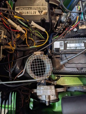

Another situation that needed to be resolved was that I could not kill the ignition with the switch. Way back last spring I had replaced cut off ground wires on the engine connector plug, putting it back to OEM condition I thought. I installed the Hewtech ignition system per the instructions, but then when I finished the wiring I had this white wire coming from the ignition switch that had nowhere to go. I remembered it had connected to something on the back of the engine, but I was fuzzy on exactly where. I tested the ignition, and I had spark whether the key was turned to on or off, so this had to be resolved.
I chatted with some sled buddies ( as CDI is not my thing ), I studied the 76 and 77 wiring diagrams, and finally dug out the original Prestolite CDI box that had been on the sled. What I learned is that I am not the first to be confused by what Deere did here. The 76 diagram shows the white wire going into the plug down at the recoil. However I have three 76 Cyclones, and only one actually has the white wire plugging in there. Reviewing the Hewtech instructions, they show a black wire on the CDI side of the CDI connector plug as the kill wire. The original Prestolite CDI had the black wire pulled out of the connector plug, and that is almost positively where the white wire on this sled had been connected when I tore things apart.
So the question was: how did I want to proceed? When I had installed the engine, I had plugged a wire into the connection at the engine plug where I thought the ignition ground was located, and left it about a foot long so I could splice into it if I wanted to use it. However, subsequent testing had showed that connection was not a ground. Confused, I had grounded the white wire to the engine, and got the result that I mentioned above. So tonight I cut the ring connector off I had put on the white wire, and connected it to the wire I had put in the engine plug. Rolling the engine over I now had a dead ignition! Turning the switch to "on" I now had spark, and pushing the kill switch made it go away! I love it when a plan comes together!

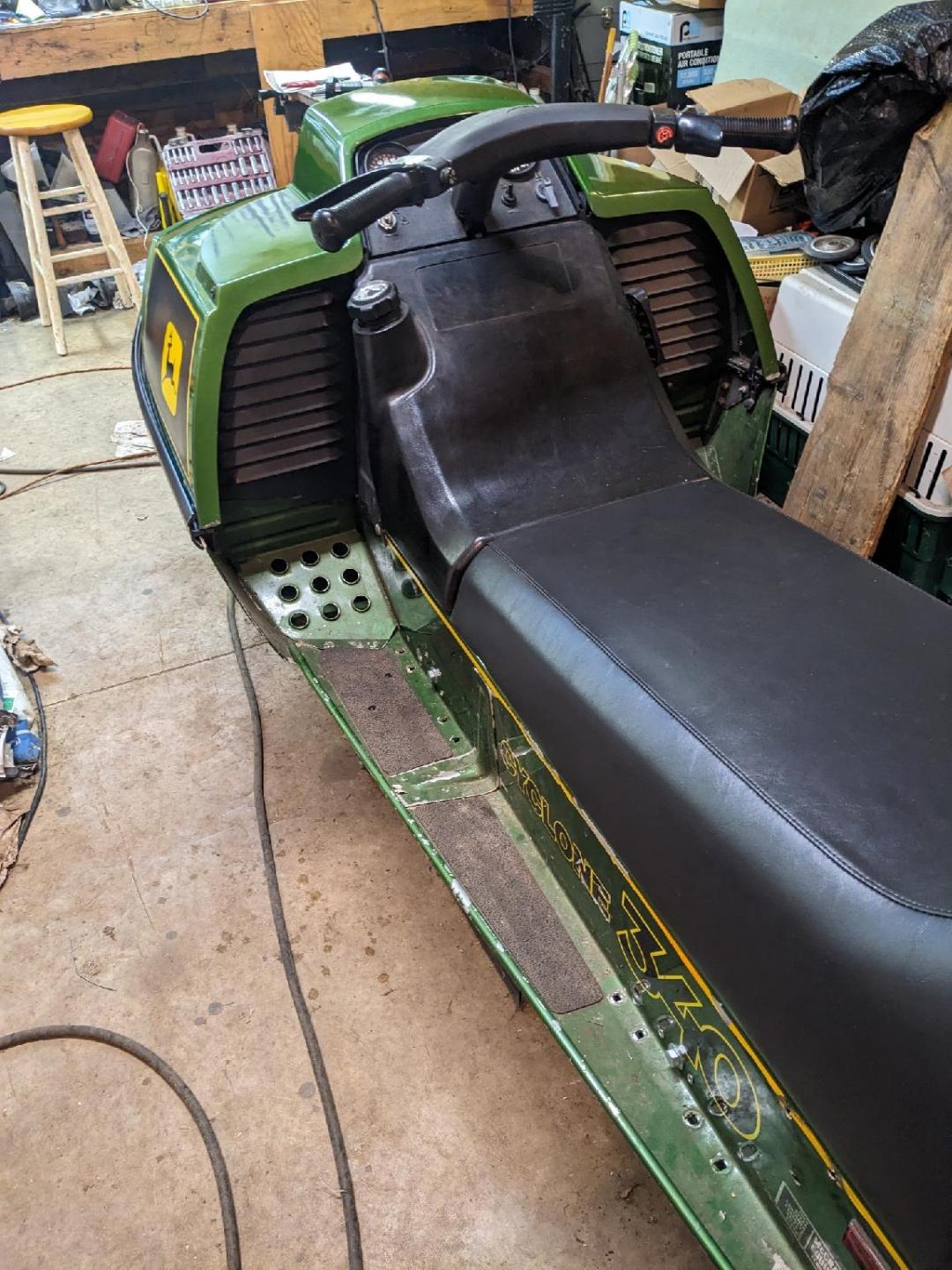

The hood is back on! Everything seems to fit OK, but wrestling it on by myself was a challenge.

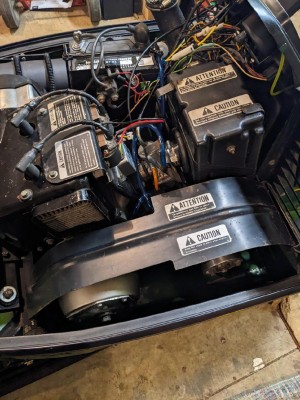

Progress is being made. I think the wiring is done, and the skis are installed. The exhaust has been installed with four new springs. The ball and socket on the exhaust show too much wear to suit me for less than 1000 miles. I gave them a coating of Permatex copper coat RTV before assembly, but I doubt that will survive for long.
Just a few things left to check and/or adjust, and I will have run out of things to do...
Always some apprehension on first start up. I did let it bark off back in August, but that is not the same as running, and running in the garage is not the same as running out in the field.

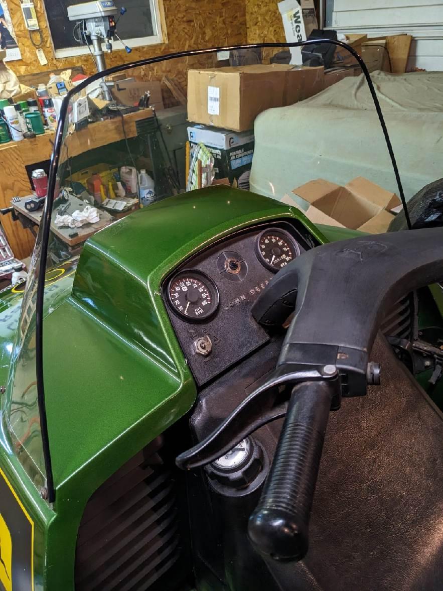

Windshield was ordered from Dennis Kirk Tuesday night, arrived via UPS Thursday afternoon. Windshield is installed, MI historic registration added as we have a trip planned to the UP shortly.

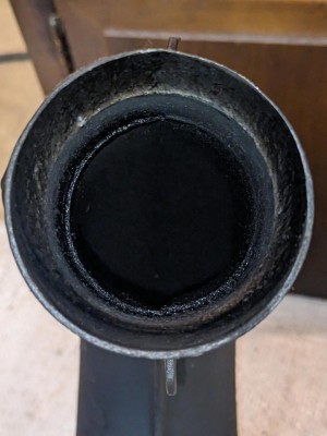

The garage was filled with smoke at this point, so I shut it down and opened some windows. I retreated into the house and watched the Viking Nation getting disappointed for a few minutes, then went back out and shot the video that I posted to FB ( JD Fanatics and my home page ).

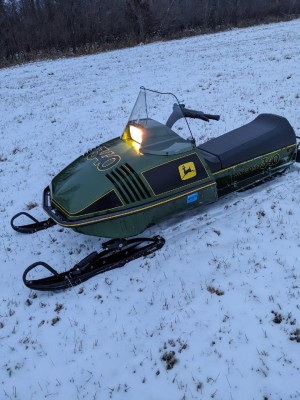

First test rip.
