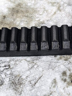

Before I took it out for a test rip, I was looking things over a bit when I noticed something…

Yeah, I noticed this strange groove worn in the drive belt that had only 100 miles on it! This needed to be investigated, so I removed the belt and the problem was immediately apparent.
The duralon bushing in the moveable sheave had relocated itself. This meant the clutch was coming off!
Once it was on the bench I disassembled the clutch, and honestly that out of place bushing was the only thing that was readily apparent. So this clutch can probably be repaired if the snap ring groove isn’t messed up inside the sheave. But not tonight, no time to mess with it now, I figured I had two or three other clutches on 340 engines that I could liberate.
