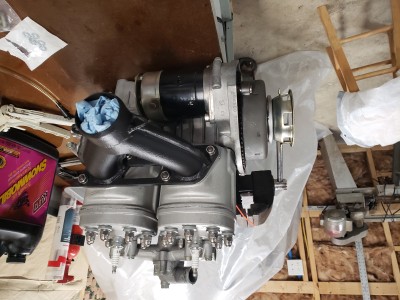

Anyway these photos were taken in Nov of 2021. As you can see the motor is mostly finished, except for a few details. I have a bad habit of letting small details get in the way of progress. In this case I was trying to get the Kawasaki sticker on the flywheel cover reproduced. In the end I gave up, masked off the decal and carefully glass beaded the flywheel cover. My other stumbling block was the coolant hose. I didn’t like the look of the old coolant hose so I purchased the R121427 hose. I couldn’t find the correct size spring type hose clamp (at a reasonable price) without purchasing a box of 10. Eventually I caved and purchased the box of 10.
Sorry....I have no Idea why the photos are upside down and sideways.
