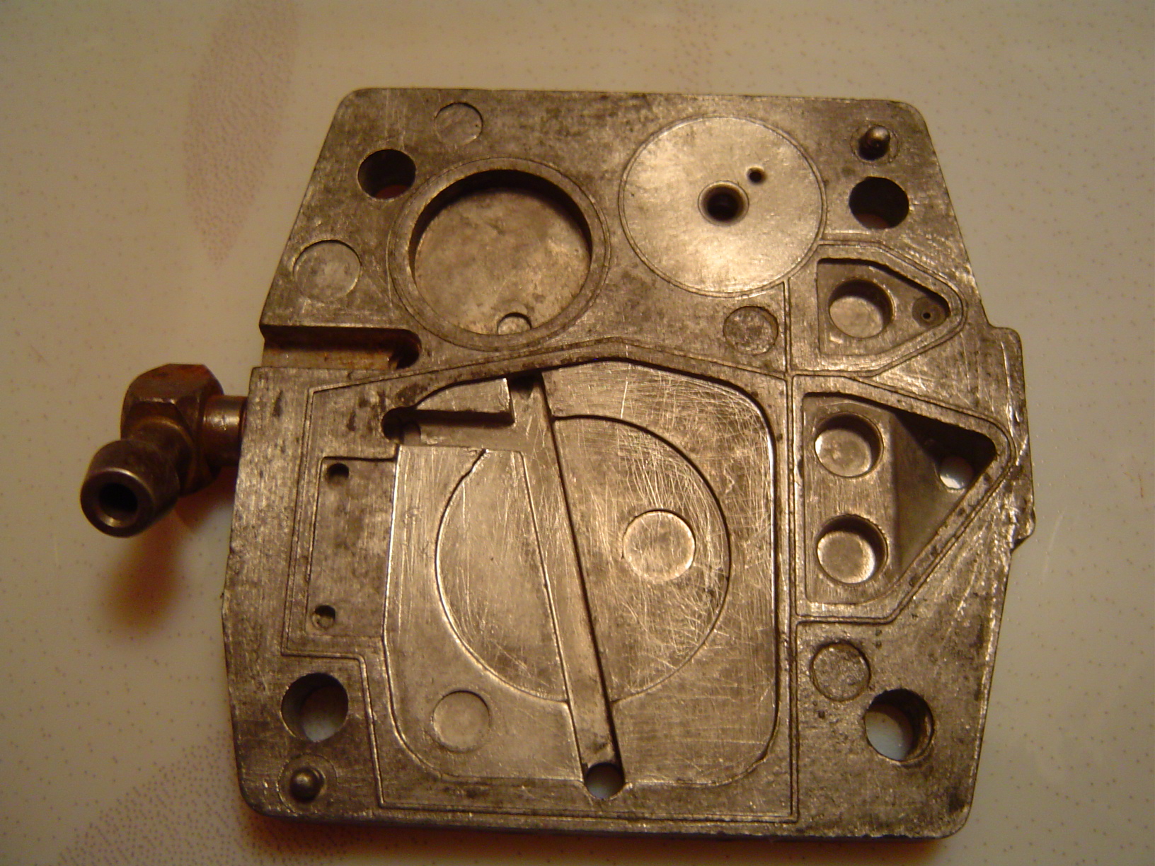

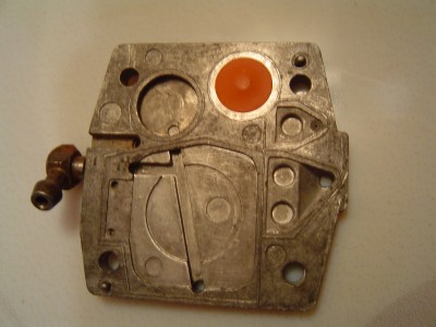

OK, so the rebuild candidate was pretty clean, and everything moved. After removing it from the solvent and getting all the old gasket material off, I noticed there was a fair amount of corrosion under the gaskets on the carb plates.
The orange umbrella check valve that goes in the above pictured plate ( in the circle in the upper right ) used to come in the full Walbro kit. Being as that kit has not been available for years now, I generally don't remove that check valve. In this case, it appeared that there was corrosion under the valve, so I popped it out to clean the area.
The orange umbrella valves are avaiable from New Breed.
