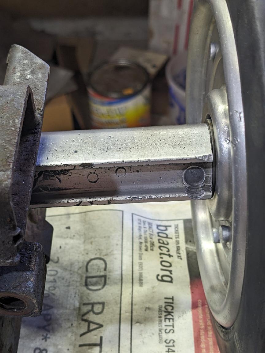

On the 78 CC suspension; Today I decided to disassemble the auxiliary idler wheel assembly that came on my suspension. Once more I had to bring out the tube and redi-rod puller I use. I threaded the rod into the axle, wound up the nut, and basically pulled the axle out of the wheels.
Once the axle was out, I removed the C-clips and knocked the bearings out of the wheels. The plan is to obtain NTN bearings from Wahl racing, and install the wheels onto a new axle with new tube spacers.
The entire suspension will get new shafts throughout, and I need to build another complete auxiliary idler assembly to replace the one that is missing.

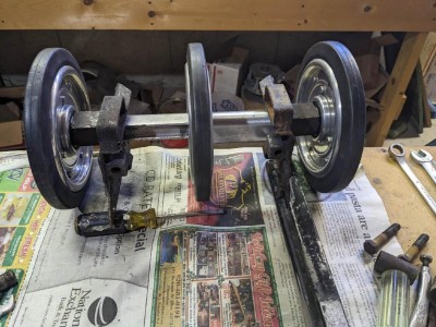

Mocking up the rear axle. At least 2 of the wheels need to have the bearings replaced, as we have found the ones I put in these were sub-standard.
The aluminum axle will be replaced with a new steel one, and a couple of new shim washers need to be found.
The aluminum teardrop spacers between the idlers are the dead giveaway of a CC suspension. The square steel spacer between the bracket and the outer wheel are just as unique, they just don't jump out at you.

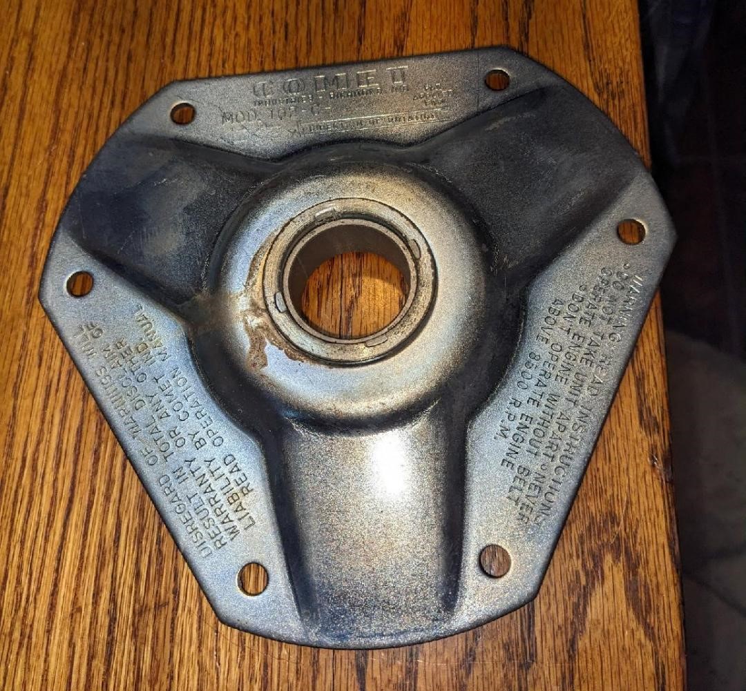

The clutch that came on the 78 LF was liberated to replace the Salsbury on my 73 X8 restoration a number of years ago. I did that because I knew I had the parts to put together a brand new clutch. Many years ago, back when there was a regular supply of NOS parts showing up on ebay, I bought a Comet 102C fixed and moveable from a guy here in Wisconsin. That was the starting point, I then bought a new spider from Central Snowmobile ( that they actually had in stock ), shortly before Comet sold out to Certified parts and there was a lull in parts availability for a couple of years.
With the 78 on the clock, everything needs to be gotten ready, so I pulled the box out today and took stock of what I had. When I opened the box, I found it was as I remembered it. It is really fun to work on something that doesn't require cleaning first! The first thing I decided to do was locate the "R" arms that I took out of the original clutch. I had seen them recently digging through the parts stash, so I was able to lay my hands on them quickly. In the same box of stuff I found a set of arm pivot bolts, and in another I found the NOS black spring I had acquired in the last year or so. The pivot bolts are an additional expense, but are so much easier to install than the original pins with tiny roll pins.
I gave the lightly used arms a final cleaning, then installed them into the moveable with only one short break to search for a shim washer I managed to drop onto the floor. I did not have an Allen wrench to hold the bolts, so that will come later. The parts book shows one shim washer to be installed under the spider, so I found one of those. The spider has to be installed with Loctite and torqued to 250 ft/lbs I think, so I will wait on that until I am absolutely sure I am ready.
At that point it appeared all I needed to finish up this clutch was a new cover. I have never had a new cover, but it seemed that if I was going to call this a new clutch I was going to have to get one. This clutch is new enough that it uses 1/4" x 1 3/4" bolts to hold the cover on, and there was a bag of them in the box with the clutch, so I was good to go there. I got on the computer in search of a new cover, found that they were $56 or more, but it didn't matter as Dennis Kirk and MFG Supply were sold out. I eventually found a place in NY that had one for $25 and shipping, so that is the direction I went.
This is the closest thing to a brand new clutch I have ever had! I think I have less in it than buying a new one, but probably only about $100 less.

Completed the assembly of the 102C. Tightened the spider on with a bit of red Loctite, that is the Deere tool. I then installed the new cover. The only used parts in the clutch are the lightly used "R" arms.
I finally broke down and bought the Comet "Grunt" tool. It is a hex headed shaft with a drilled 30 mm taper that simulates the crankshaft. Interestingly, the bolt that a /22 Kioritz uses to retain the clutch is too long, it bottoms out in the tool before it gets tight. I found one that would work in the stash, I don't know if it was from a Salsbury clutch or what, but it was a bit shorter and worked.
The service manual has you hold the clutch with a drilled square nut that fits over the end of the clutch shaft, and a bolt goes through the hole in the shaft. I'm not sure the Comet tool was much of an up-grade. Comet says to tighten the spider to 250 ft/lbs. The Service Manual simply tells you to tighten it. I put the breaker bar into the Deere tool and pulled till my eyes bugged out and called it good.
