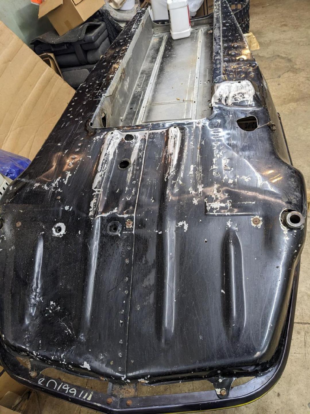

Recently I have returned to cleaning the black goo out of the pan, straightening the ribs in the pan, and cleaning the top of the tunnel where there had been a lot of corrosion under the seat. I finally pulled the chain case out to get things clean, found a fish hook under it.

Continued working on getting the inside of the pan clean. I have also been massaging the dents out as I go as a distraction. The ribs in the center of the pan are with few exceptions always messed up, and the bump out under the chain case is generally as well.
I am making progress. I had purchased a gallon jug of BrakeKleen, and a gallon of a paint prep product. Neither were cheap, but the paint prep product doesn't smell nearly as bad, and is more gentle on paint. Power washing or steam cleaning would have been a better option, but we are long past that idea now.
With the dents worked out of the area under the chain case, and the black goo cleaned out of that corner of the pan, I cut a new cork gasket for the 80 chain case and bolted it in place. I have a pair of new oem style bearings coming. Once they are here I can install the jackshaft, hopefully for good.

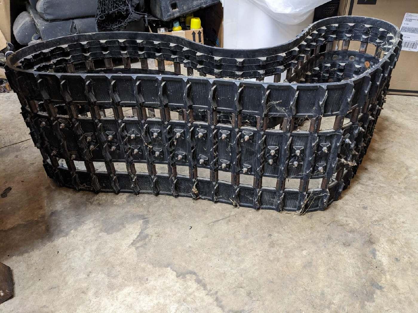

I brought the track I intend to use into the garage tonight. It will not be used "as is" I have at least a couple of things to do to it.

Very interesting track you have there.
Re: 78 Liquifire rebuild!
The track is an Arctic Cat part that a number of guys have used to convert Deere sleds to a rubber track. They are obsolete, but used ones are fairly common. This particular track previously had been on one of Rainville's racing projects.
