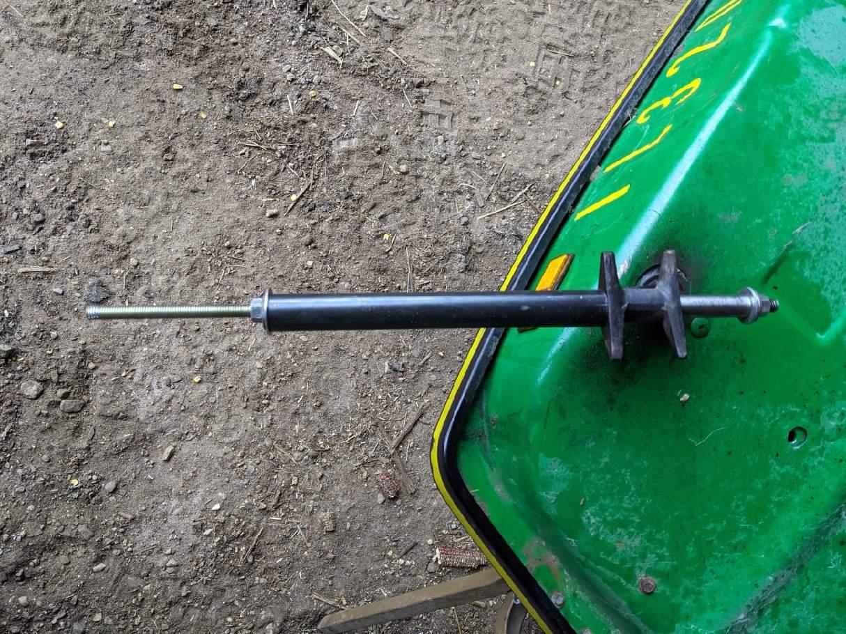

So the new shock shaft arrived. This shaft is part M67802 and was used on the early Spits both as the lower shock shaft, and the shaft at the front of the rails that the suspension limiter strap attached to. On the later Spits it was used only at the front. It is a 7/16" diameter shaft drilled and tapped for a 5/16" bolt on each end. Cleaned the surface rust off, and still need to chase the threads. Some nylon bushings went on either side of the shock to keep it centered, but they were sacrificed to heat the shaft for removal. Probably going to use aluminum tube in its place.

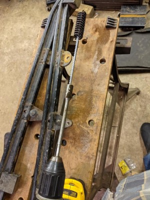

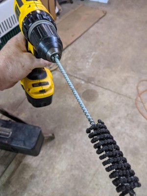

Matt Gabler had suggested that a dingleberry hone was the way to clean up the bore of the tubes. I had never owned one, so I got on-line and rectified that. This 3/4" hone is advertised as 120 grit, and was less that $20 plus shipping of course. I had to use an extension to reach to the center of the longest tube. Really worked slick, I lubed it with a little 2-stroke oil cause that is what is in the oil can, and in just a few seconds, the bores were looking 100% better. I don't think these hones are hard to come by, but if anyone is looking for a 3/4" model you can go here: https://regismanufacturing.com/3-4-x-19 ... 1ZW9dje6nY
