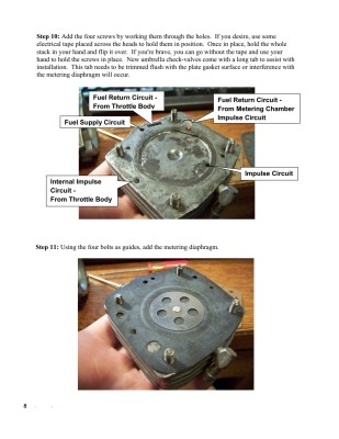

Thanks for the response Jason in regard to replacing engine seals without splitting the case, where can I find a copy of that SM2100 manual? I'll consider looking at doing that for sure. Also, good info on the case size of the oil Dan, thanks for that, I'll have to ask father-in-law if he remembers buying more than 1 case of oil, if that's the case, pardon the pun, the sled has maybe 3-400 miles tops then, I'll report back. Now still struggling to get this thing to fire. Replaced the spark plugs and confirmed engine has good spark, tore apart the Walbro carb, cleaned the dickens out of it and installed a new fuel pump kit, replaced the in fuel tank filter/check valve so fuel is now pumping up to the carb. Noticed on disassembly though that the aluminum pump leaf was missing the end with the two small tabs, no idea where that went, only thing I can figure is that my nephew who was working at a local John Deere dealership at the time, determined to get grandpa's sled running again, took it apart and maybe it broke when he was cleaning the carb, IDK, cause it was just laying in there attached to nothing. Anyway, bought a new one, put back together actually got the sled to fire and run for a short time, but then it died. Proceeding to pull and pull and pull some more, I noticed fuel basically pouring out the exhaust so that's not good. Took it apart again and noticed the the Umbrella Check Valve looked quite deformed and was missing most of the stem. I ordered a couple of new ones thru New Breed Snowmobile Parts, and am currently waiting on those to arrive, then we shall try again. Really hoping that's the issue with the fuel pouring out.

On the flooding my recent experience in rebuilding a Walbro is that they’re a bit finicky to get the lever arm right - the aftermarket rebuild kits change how high you set the level. 400Brian can probably shed more light on the topic than me.
Edit: the stem of the check valve needs to be trimmed as well:

Yes, the tail on the umbrella valve is just there for installation. Once it is pulled into place, you snip it off.
As for the fuel running out the exhaust...it sounds like the metering arm needs to be lowered a bit. We have a Walbro tutorial in the FAQs .

Update on trying to get this sled to run, finally some Great News! Had to tear down the carb a couple times to adjust that metering arm like cdnturboz and 400brian suggested, and after that, she started first pull and stayed running, idling perfect, I was kinda beside myself in disbelief lol! But, I was still skeptic that like the last couple times, it wouldn't start again after the engine warmed up, I waited a couple hours, started first pull, let it sit overnight, started first pull with no choke. It's like this sled suddenly thinks it's fuel injected. Sled is kept in a heated garage so maybe that has something to do with it, but whatever, I'm pretty pumped that it's working, no fuel leaks and the fuel lines stay full so the fuel is right there when it needs it. Pretty snappy for a whopping 27hp engine lol! Now I've had second thoughts about keeping it, but I'm thinking someone else may appreciate this sled more than I. Any takers? lol! Feel free to private message me.
