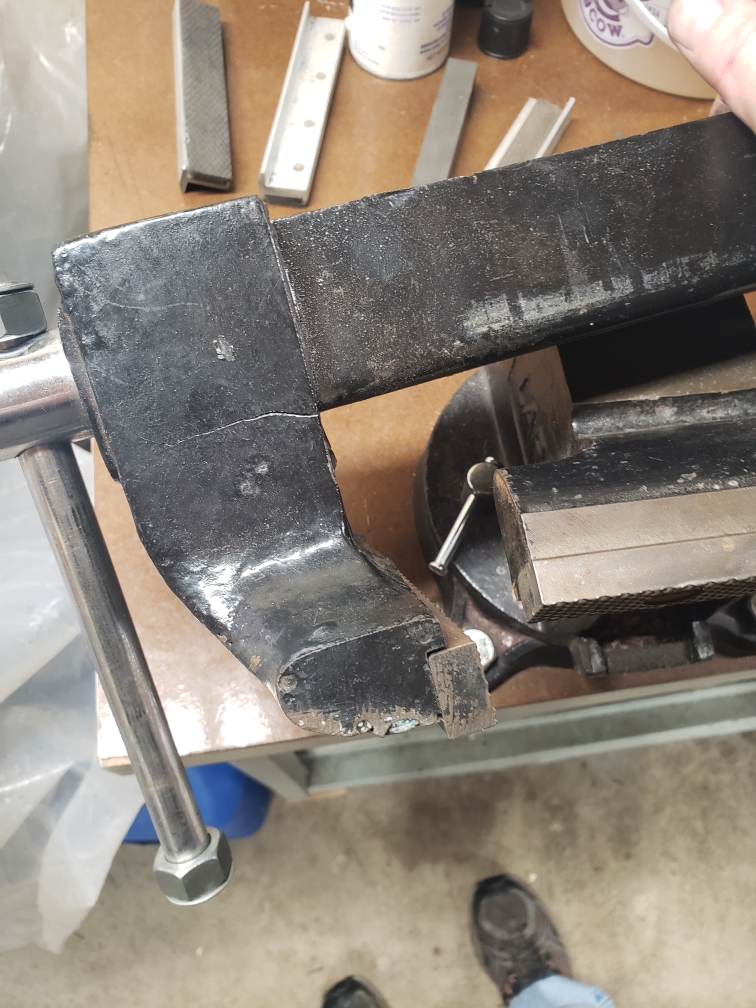

Well......more progress was made. I believe the TR800 is finished. As normal, it was not without drama (my 23 year old Chinese vise didn't survive).
In past years when I have rebuilt 102s I would take them appart at home do as much as I could at home and then take them to work to torque the spider. The main reason for this was that I didn't own a torque wrench capable of going to 250 ft lbs per the specs for the 102 spiders (in recent years the torque wrench situation has changed). The company that I work for has been around for almost 150 years and there are big beautiful very old vises on just about every work bench (Parker, Columbian, and ect) which are more than capable of handling the task, unlike my Chinese made tractor store special. My intent was to take the spider on the TR800 to 250 ft lbs, but I know I didn't get there before I heard the crack, which at first I thought was the TR800. It felt like I was close to 250 so I left it at that.
So from there when I went to install the cover I was struggling quite a bit to press down the cover, keep the ramps in place, and install the cover bolts so I decided enough was enough and made a tool to compress the cover.
This is nothing more than a chunk of 3/4-16 bolt that I drilled then cut a piece of 1/2 threaded rod and plug welded the two together. It worked pretty well and is something I can toss in the drawer with the clutch puller.

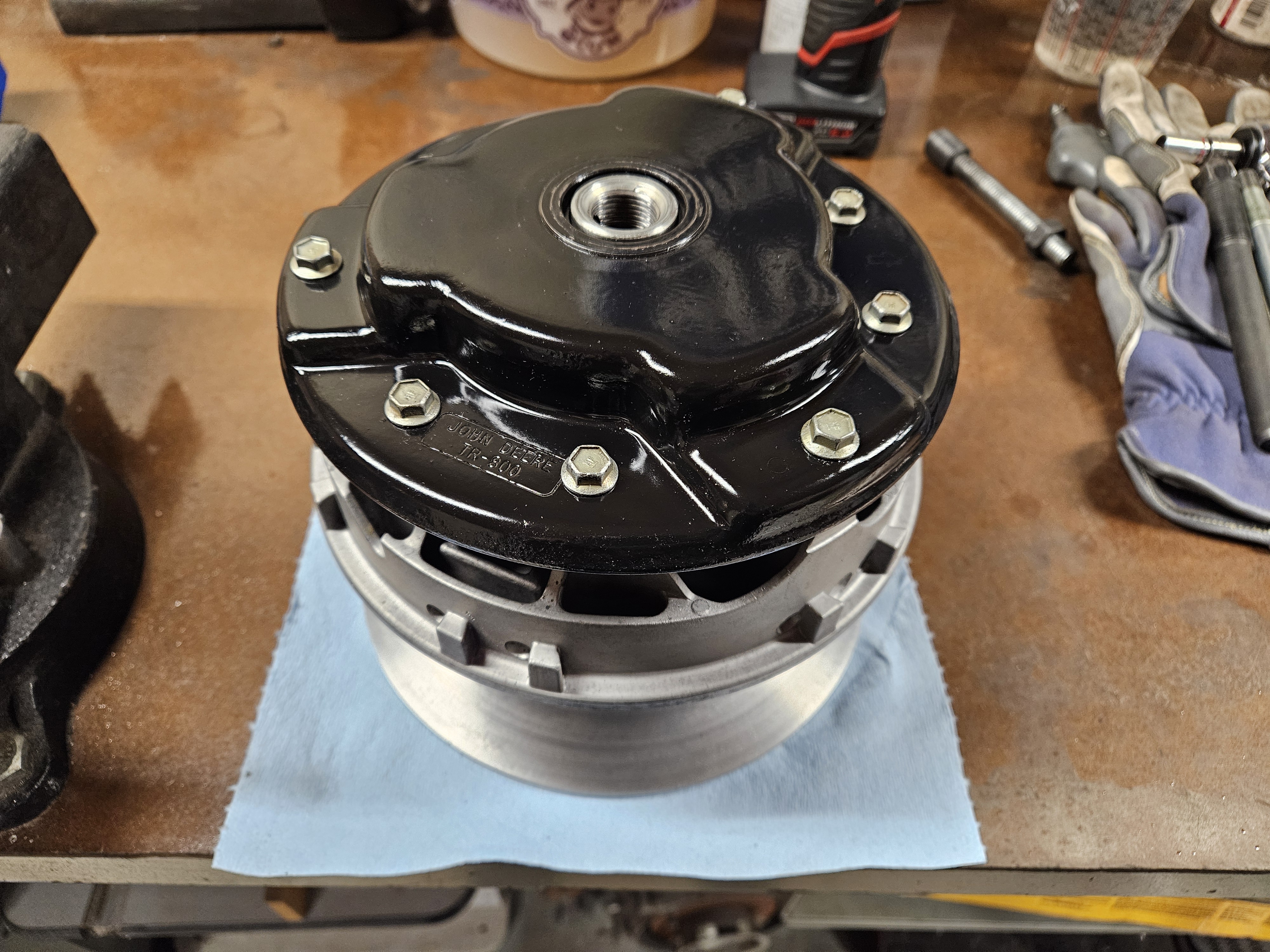

And here is the finished clutch

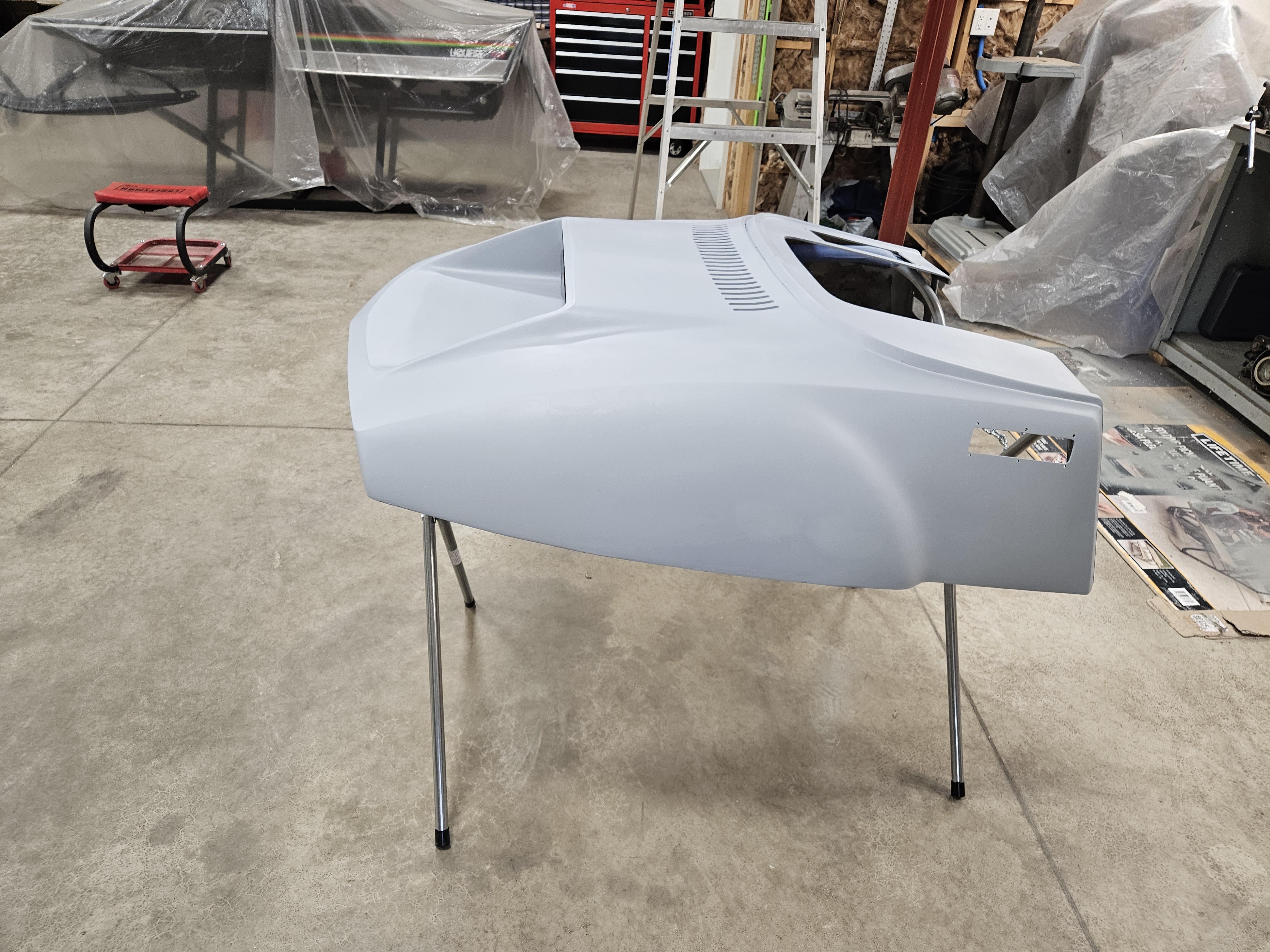

Went shopping for paint supplies this weekend. I knew this was going to be an issue and sure enough it was. The local Auto parts supplier where I typically go for paint went out of business. Unfortunately this means that I will be using a line of paint I haven't used before and the shopping experience was less than ideal. Once this hood is done I do not think I will be using this place for paint supplies again. The experience left me flustered enough that I forgot to stop at the hardware store for a can of flat black (that I use as guide coat).
Anyway, I did manage to get the first coat of primer on the hood. I didn't mix quite enough and was running low when I got to the side we are looking at, which is why you can see the body filler shadow. Turns out there were some fine cracks in the hood where decal was missing. I ground those out and used some bondo glass in an effort to stabilize the crack.
Hopefully I will have a little time during the week to block this down and spray the second coat of primer.

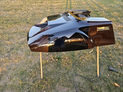

Well....the last month has been full of disappointment. I'm definitely not a professional painter and I regret trying a different type of paint. My first attempt at painting this hood turned out terribly. I think I could have gotten a better finish using a popcorn ceiling gun.
After putting in a few hours of sanding and buffing this is what I have. I think I can live with this. I intended to let it set for a few days to see if it clouds up and if not we will move into decals and putting components back on the hood.
I should have just scuffed it down with 600 and re-sprayed but instead I decided to try to wet sand and buff. After spending about 2 weeks messing around I had this.
I was surprised how much it improved but you could see pin hole low spots. I tried to sand more but eventually burnt through to the primer. That spiraled into trying to touch up and blend remember I'm not a pro so this didn't turn so well and was definitely visible. So after all of this messing around I scuffed with 600 and repainted. This time I cranked up the air pressure and used more than the recommend amount of reducer and it came out better.
I still wasn't real happy with this second go and debated for about 2 weeks what to do with this thing. A co-worker that does body work as a side gig suggested I scuff, seal and use Urathane, he's not a big fan of enamel paints and unfortunately that's what I bought for this one. I felt like he was right but the more I thought, it seemed to make sense to make one more attempt at wet sanding and buffing. My thought was if I fail again I would go the seal and re-spray in Urathane route. After putting in a few hours of sanding and buffing this is what I have. I think I can live with this. I intended to let it set for a few days to see if it clouds up and if not we will move into decals and putting components back on the hood.
