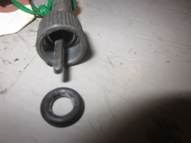

For a speedometer with a needle that hunts all over the place, try installing a small O-ring inside the upper cable fitting before tightening it onto the speedo. It probably won't solve the irritating problem on every sled but it totally corrected the issue on my 1978 Ski-Doo Elite and also went a long way towards fixing the problem on my 78 JD Cyclone.
