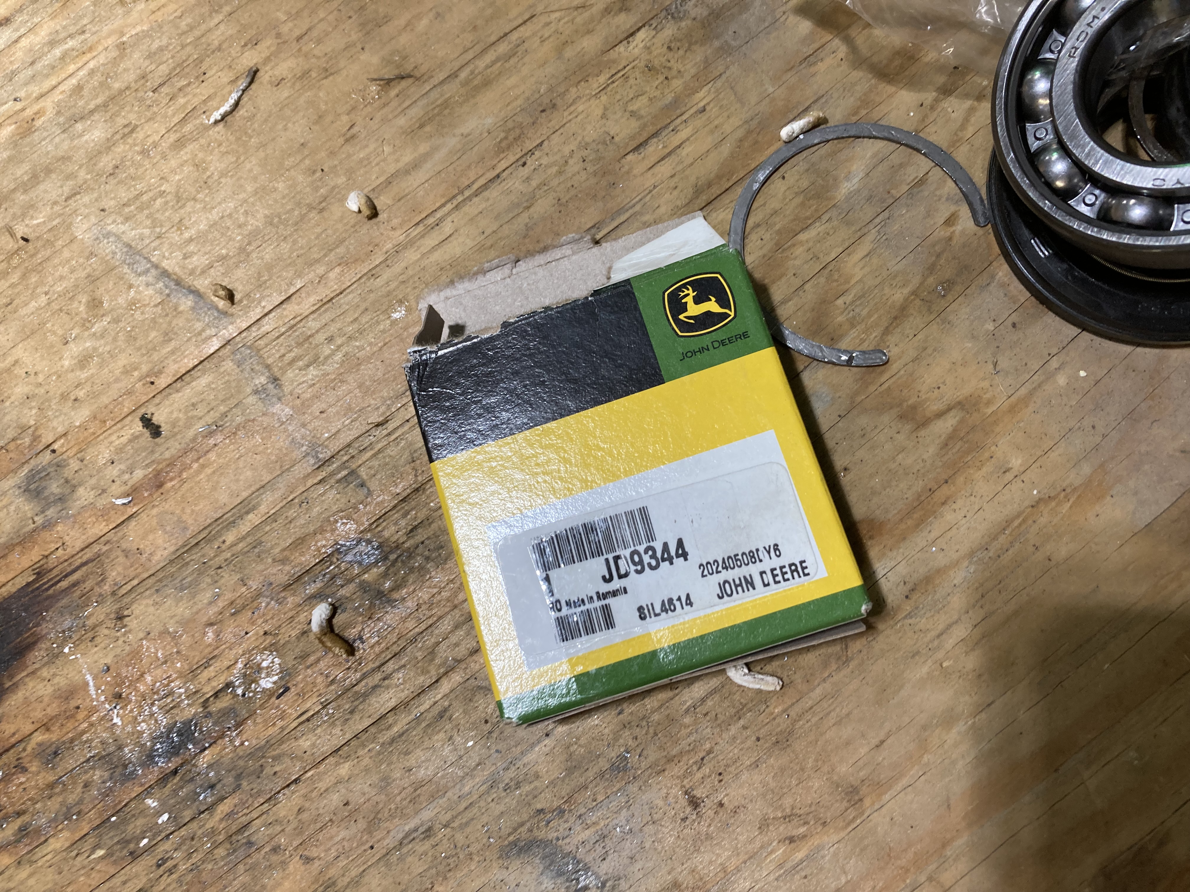

Hello everybody I am new to this forum. A year ago I received a 1981 liquifire from a guy that was going to restore it but lost interest. The sled is completely torn apart and I have since torn the motor down. I am at the point of putting in a new outer crank bearing on the gear side. This is my first restoration. I am slightly overwhelmed and have almost no clue what I am doing. I also do not have all the parts I need as it was torn apart by the guy before me. I am missing a seat and the secondary clutch is broken. I will post as I go along with questions. Later today I will get some pictures.

Deere still makes the bearing for the pto crankshaft end and the one in the gear case as they are the same.
