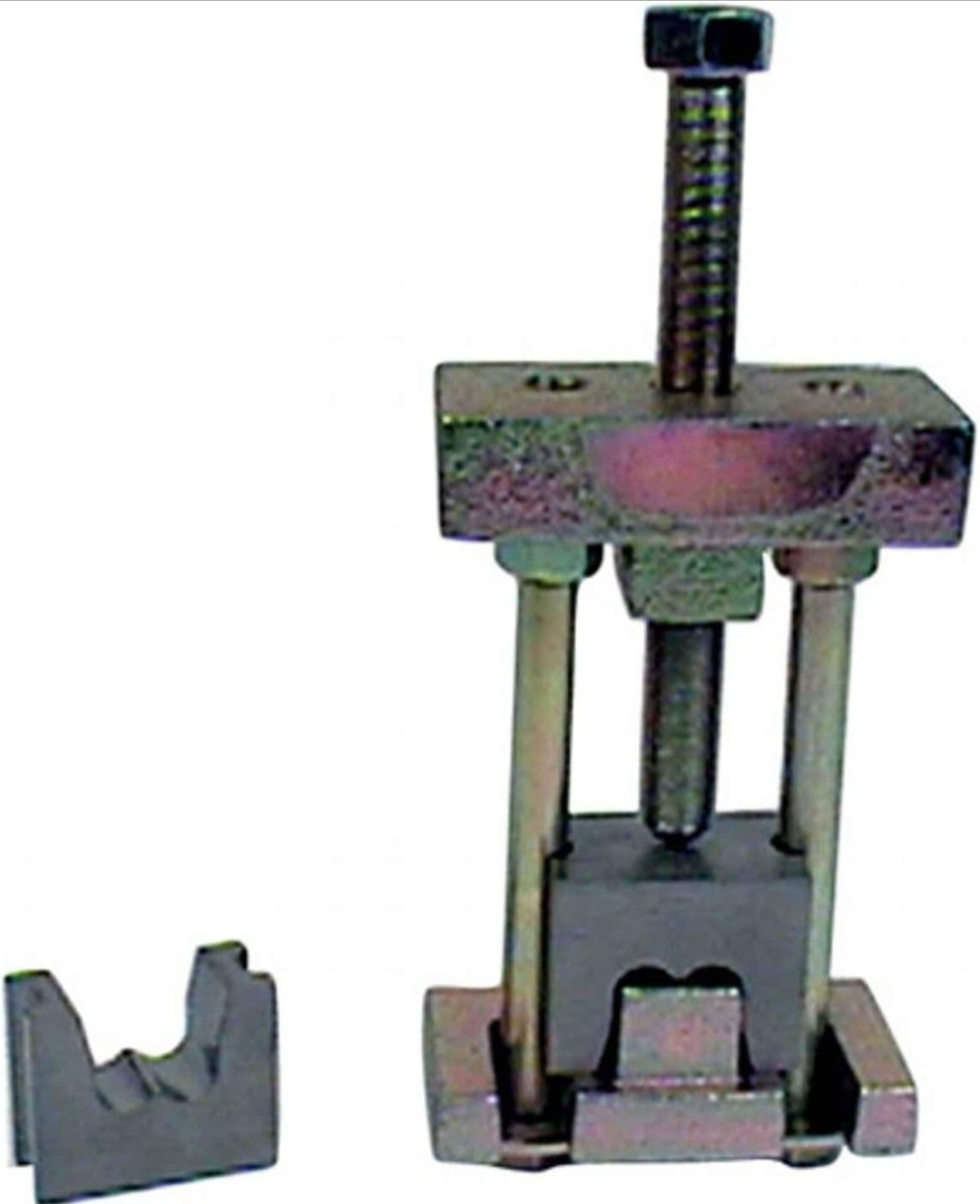

30 years ago I borrowed a tool and replaced all of the clips on one track. Back then I swore I'd never do it again. Today, I might consider it. Unfortunately, I don't know the exact make of the tool I used (LeMans, Parts Unlimited, Kimpex?). In the 90s most of the aftermarket mfgs made tools that looked similar to this.
Most of the tools I see today look like they are for a 3" lug track and I question how well they would work. I've never used the bolt cutter style. My opinion, re clipping a track is a miserable job. It took hours and in the end I felt like I put a bunch of money and time into a mediocre track. With nice tracks getting harder to find today it probably makes more sense.

I did half the clips on a rubber track a year ago. If you look on the restoration topic under 78 Liquifre, I documented what I did there. I used a tool similar to what is pictured here. I did have to modify the forming die because it was cutting into the track.
