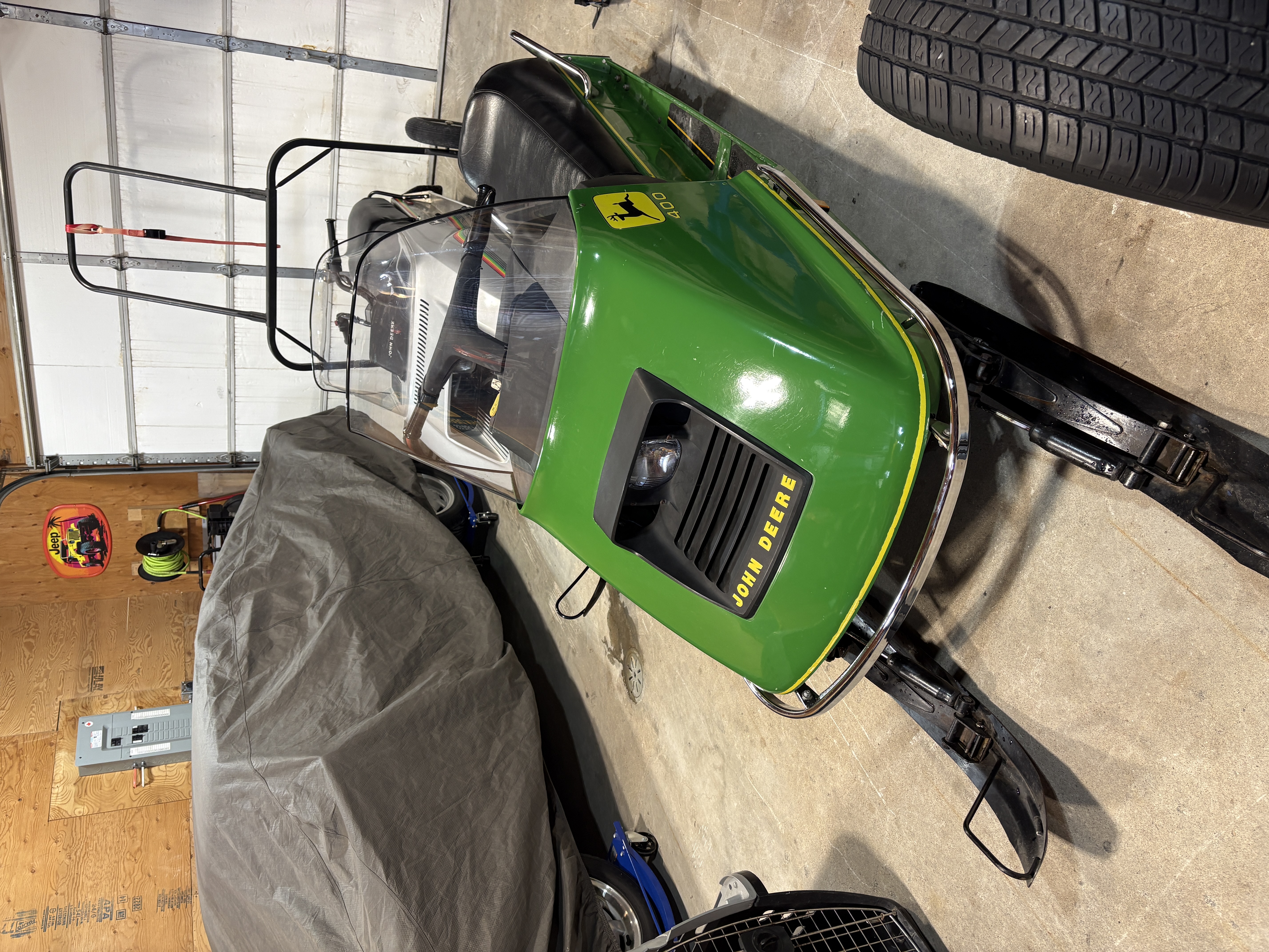

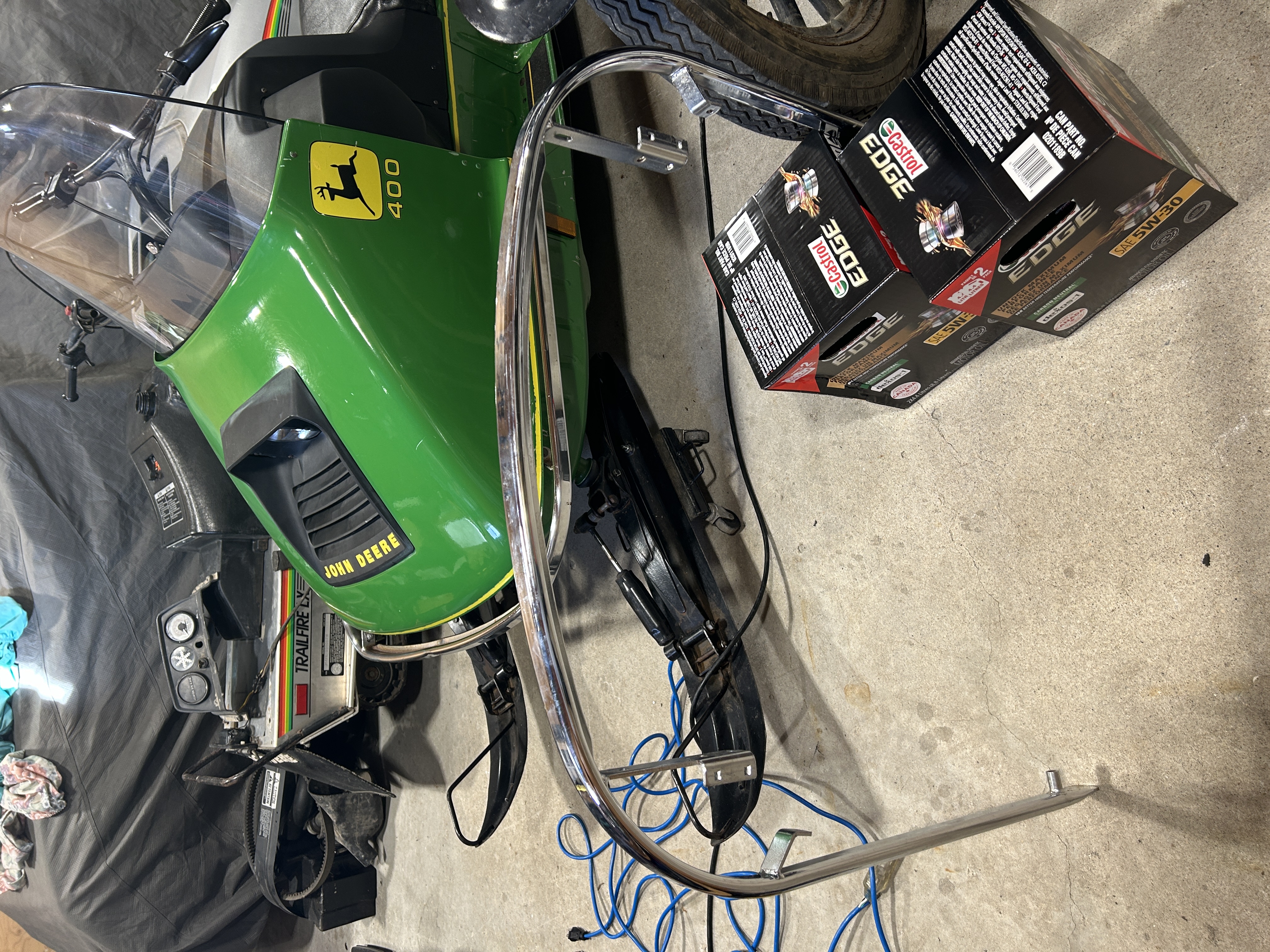

Getting the sled ready for the CPTC vintage show this weekend - found a NOS bumper only a few miles away from me for a great deal. Needs a quick polish from sitting in a shed all these years but should make the sled look better .

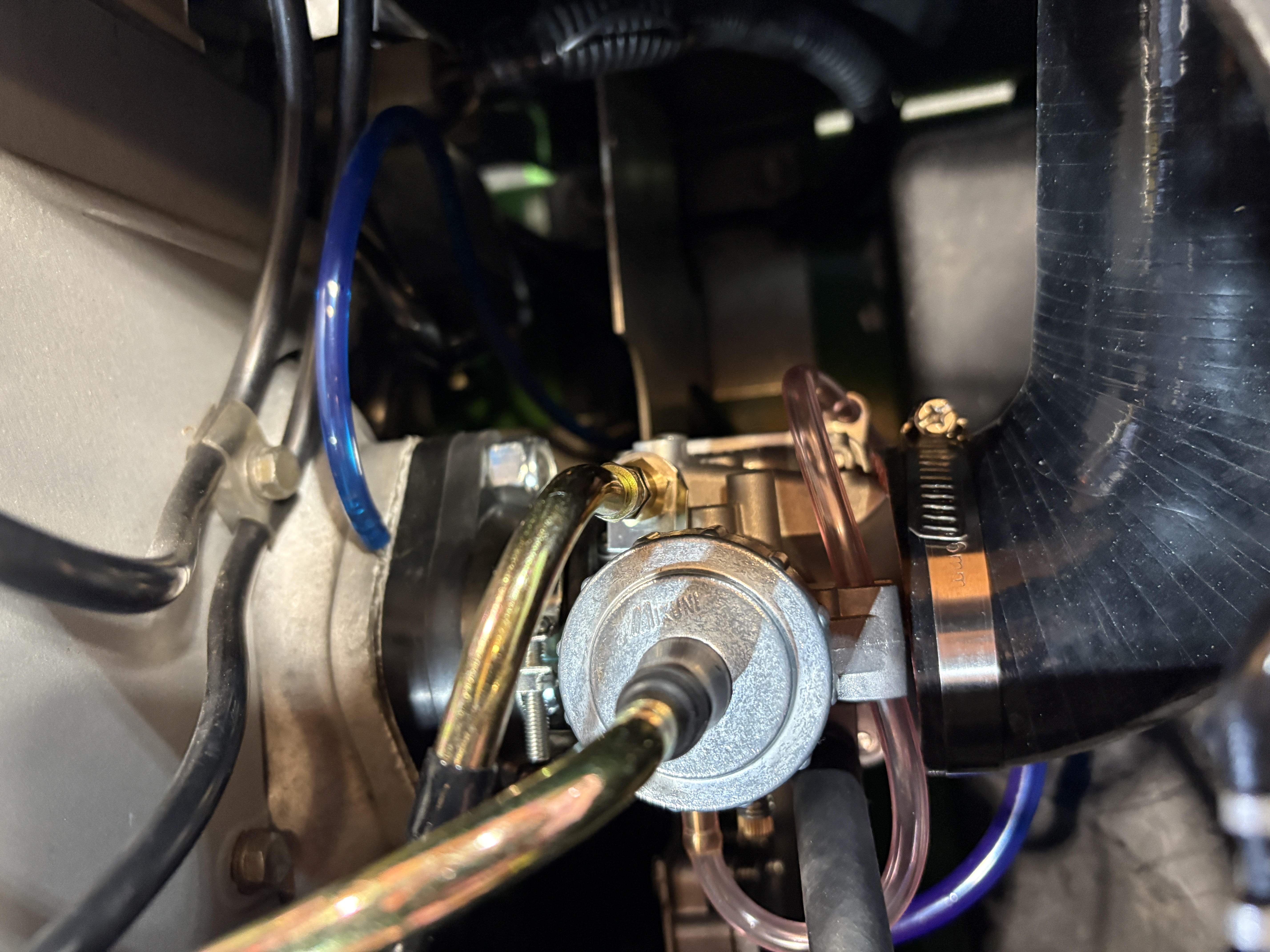

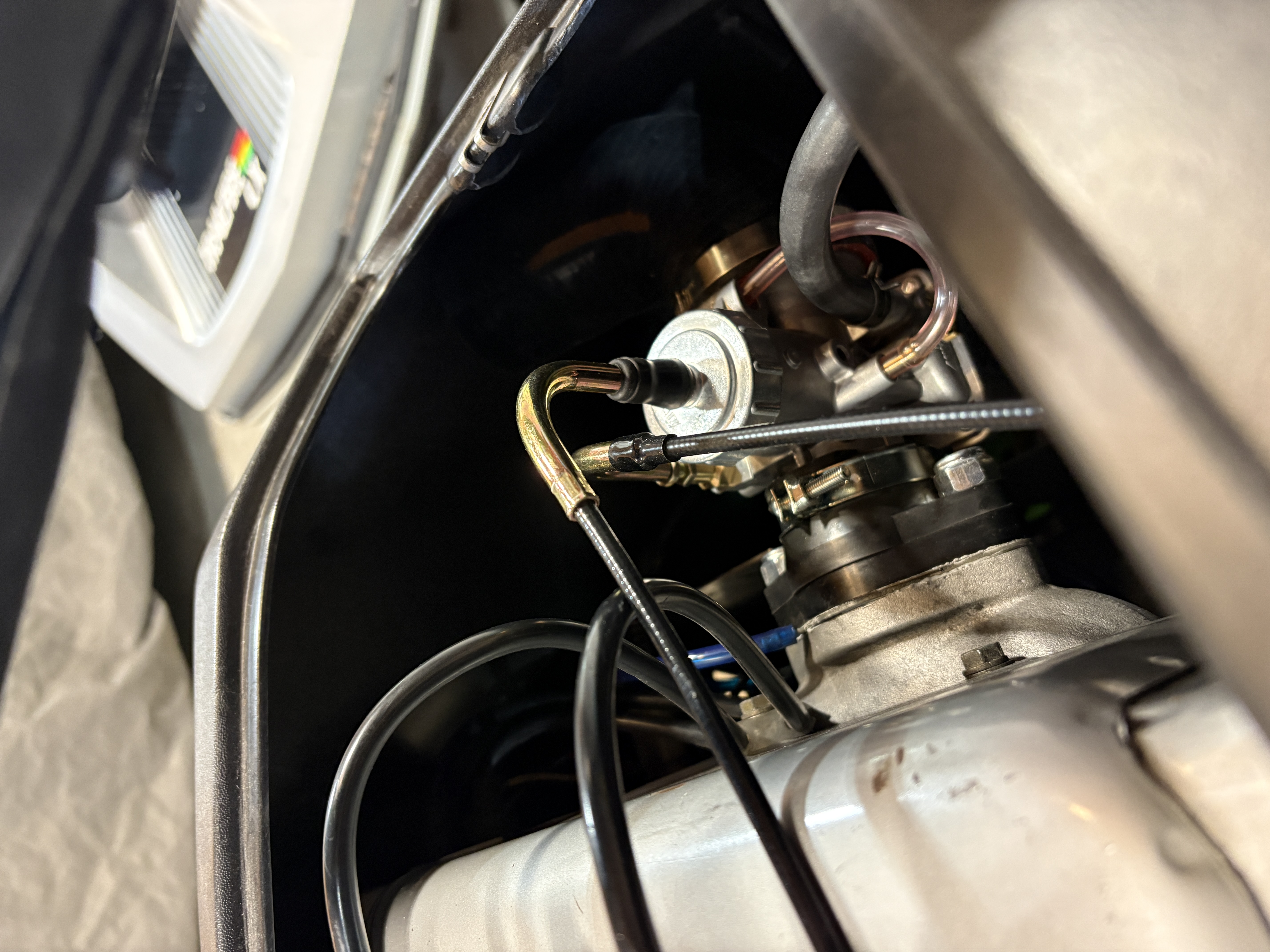

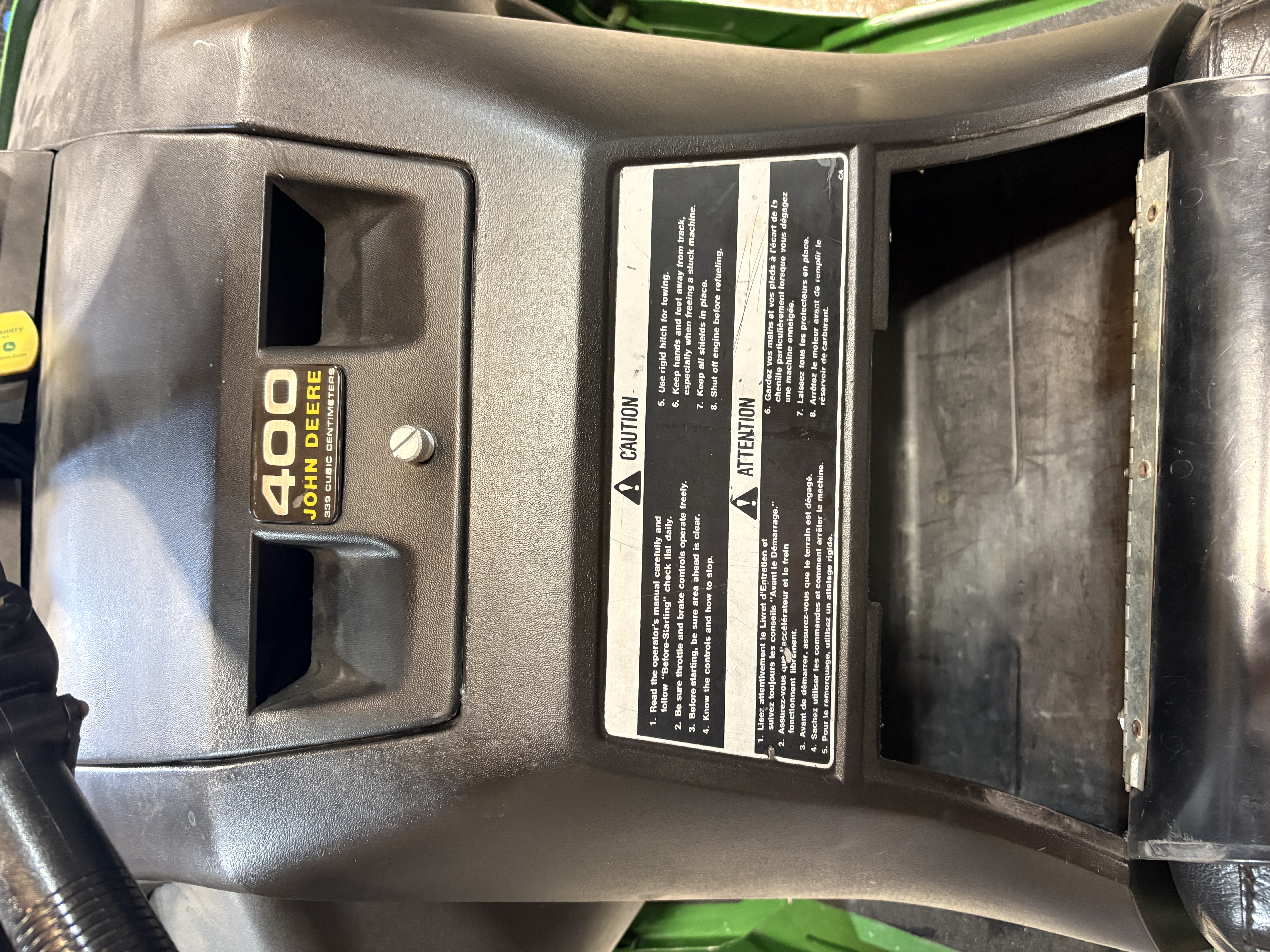

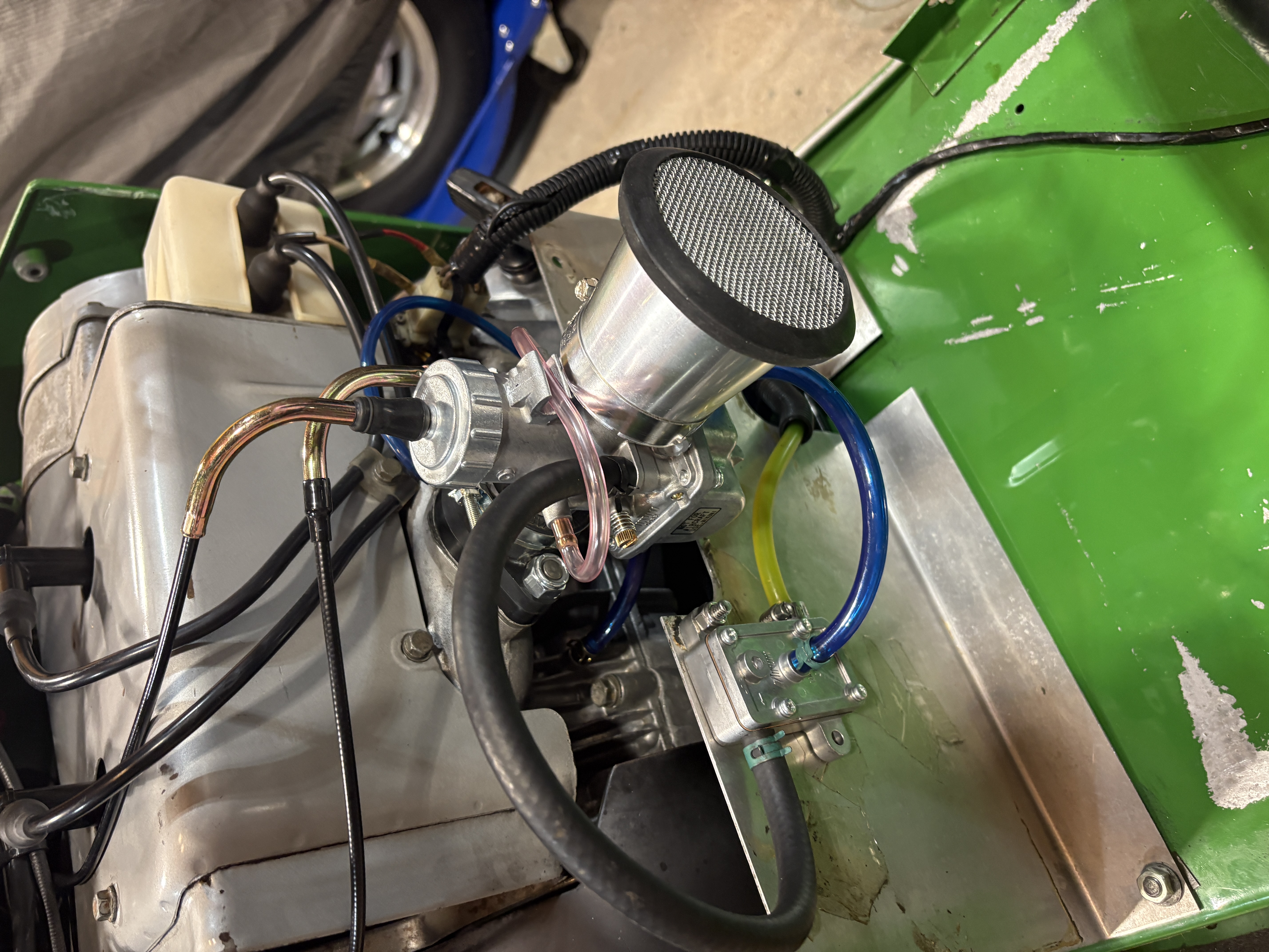

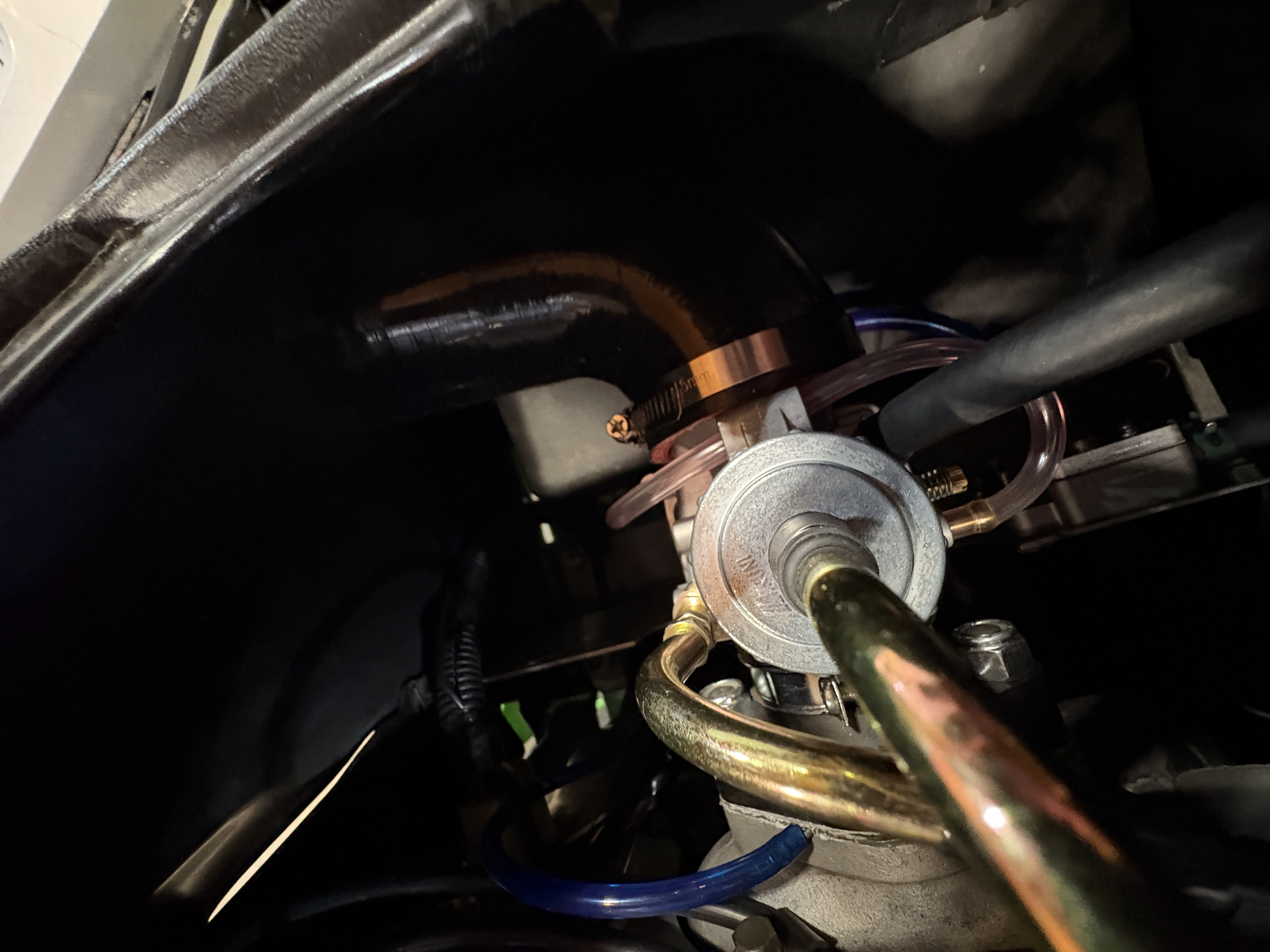

Got it fully back together today, seems to run much better vs the Walbro or Bendix .
Been researching this for a while and never got a definitive answer. You ARE able to keep the factory glove box. Once cowling was back on i added a cheap 2 1/4” ID silicone 90 and tilted it slightly up so no gas/oil would run out if the carb ever spits some fuel back.
I had to mess with setting the choke and was able to actually remove the carb without removing the cowl which is a huge plus. (Just removed my silicone 90 first) I might look at adding a more ushaped silicone hose but will try this for now.
