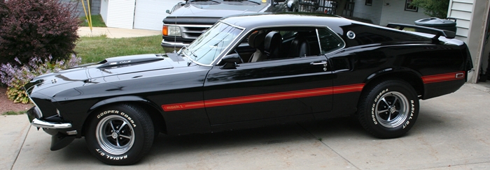

I found that Harbor Freight has pretty decent " cheap " tools. I painted my 69 Mach 1 Mustang with their purple el- cheapo HVLP gun and it worked better than the Binks I have. They have bearing seperators for 40.00 to pull bearings for cranks seal jobs.
- IMG_0234b.JPG (152.12 KiB) Viewed 25146 times
Re: tools, techniques, shortcuts, bargains
Holy crap that thing is nice. Too bad it isn't a Chevy.
it got an fe in it??
