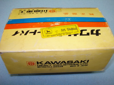

RE: 80/81 LF vs. Invader....Ignition timing curve difference?:
Was there a different Ignition timing curve due to cylinder head and compression differences between LF and Invader? No answer here, but the Kawasaki CDI part numbers are different LF vs. Invader, and the external wiring connections and color codes appear to be identical....suggesting internal electronic differences?
80/81 LF CDI AM54840 = Kawasaki 21119-3001, See photos (2) below of NOS JD part in Kawasaki box.
Invader CDI = Kawasaki 21119-3002 via Kawasaki parts manual
