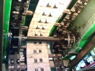

Re: drive shaft bearing flanges/gasket/oring
Hoppy,
Check out the picture of my Cyclone. The thick spacer goes up against the tunnel on the speedo side. Make sure you install the bearings with the locking flanges facing the splined end of shaft (chain case side).

sure looks like this one was put back together wrong by the previous owner based on your picture.
harley........what do you mean "locking flanges"? i can see in your picture that the flange on the tunnel is lip out on the case side. the bearings that came off have a flange built into them. i would think it would be flange end in towards the drive cog on the bearing. same thing on the other side. flange on the bearing facing inwards? correct?
YesHoppy wrote: does the o-ring simply slip over the bearing in between the two flange plates?
The locking flanges are the extended part of the bearing on one side. It is not perfectly round. The picture can be misleading because not all tracks have the center drive lugs and also my Cyclone has a Trailfire hex driveshaft.
my 77' has a hex drive shaft with no center wheel.............is that not original? mine looks exactly like yours does in that picture.
The hex drive shaft was a replacement for failed round shafts. The center idler was deleted for the '78 models. Basically when the hex shaft was used, the center idler was deleted as well.
